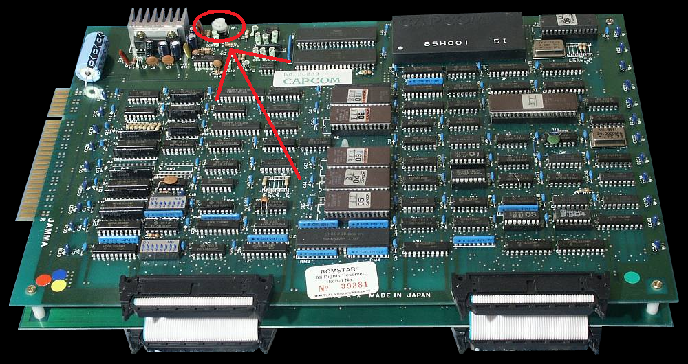

I need a volume control in my cabinet, no idea why there isnt one. I got a board with no adjustments allowed to be made on the board, so I need one. Can someone tell me what to do, im sure its easy but no idea what to do. thanks!

Bear in mind that some pcbs will have a volume pot on the board, some will have an external volume that connects as above, and some will have an on-screen volume adjustment...
alright thanks mod. So thats a universal one and should work with all or no? I just got a black tiger board, doesnt seem to have a volume control and also nothing in the game to adjust it. But all my other boards have there own, so if I add it just for this I should be alrigh?
Black Tiger should have a volume pot on the board a couple inches down from the big cap...
