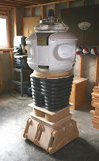

This is the bottom of my NBA and I need to get it sanded down. You see that damn wooded frame for the change door / box?
Can I remove that frame then put it back? I really want to sand that floor in this beast a whole lot better!
It just looks like ass like it is...
On another note whats the best "accurate way" to cut that bad back handle out? Once I get it cut across perfect I can cut a longer door for it.

You'll need a media blaster and fine wood beads. Just kidding..
I would just get as much as you can with an electric sander, which looks like you'd done. You'll have to use a sanding block for the rest. Get the rubber block the paper goes around or just wrap around a wood scrap. The worst mistake you could use is starting with too fine a grit. Start with 220 grit and you'll feel like you're getting nowhere. Start around 100 and work finer as you clean that up. You'll need something aggressive to get the mess out.
I think knocking that box part out would be WAY more trouble than it's worth.

As for sanding, a profile sander will do the trick just fine.
As for the door, it looks like crap particle board, if it can't be unscrewed remove it all with a circular saw set to the depth of the wood or a router with a guide and a straight bit.
