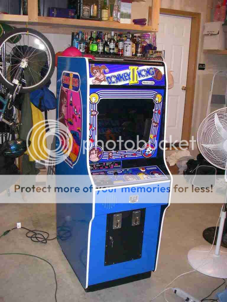

Automotive paint was the best paint I have ever used. Goes on perfectly smooth with no orange peel and is completely dry in like 10 minutes. The only thing that prevents me from using it on all my cabs is the cost. It cost me $388 for the paint to do this:

Let me try again. I'm going to be using base/clear leftover from cars Ive painted. Ive been painting cars for almost 15 years now. That DKII looked really good! I think I am going to use a flattening agent to make it semi-gloss though. I dont think these cabs look right super shiny. I'll get pics of the process.
I paint all mine with Base/Clear. Matter of Fact, my Pacman, and Ms Pacmans won an award at the Texas Pin Fest last weekend.
Your stencil work looks really accurate and clean and they look great, but.. I prefer, and think a goal for a lot of us is to get something that looks original as possible. First being the art, color, etc.. but the sheen plays into that also. Looks too glossy to me. I don't even like to get the coin door black paint too glossy, if it wasn't originally that way.
