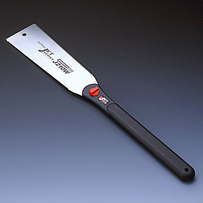

Just cutting those slots was a 2 hour ordeal in the fading daylight, I did the right side and then realized I couldn't do the left side since the little battery powered saw wouldn't fit, the the @#$@# battery died. I used a rotozip and thankfully found a piece of wood to use as a guide so I didn't completely butcher it on the left side. Once I got the front piece cut out, I realized I was just able to cut a slot using what was left of the saw, then just use a wood hand saw to complete the cuts nice and clean.
Actually what was supposed to be an old fashioned wood hand saw was actually some new fangled saw that looked like a steak knife on steroids. Sharp as shit and cut awesome. I'll see if I can find it.
Found it - figured I'd post it up here as this thing was awesome (and have no idea where it came from)
Its a Japanese pull-saw (cuts when you pull, not push). There's a course side and a fine side - I used the fine side. I also accidentally "touched" it and instantly put a knick in my thumb.
