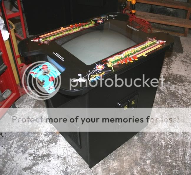

It can be done of course, but the devil is in the details if you want a really nice finished product. I built a few of these based on the Midway design, but working out monitor clearance and mounting is tricky if you want it to open and close properly.
I'd say go for it, just plan on it taking longer than expected, and start with the monitor being your absolute value on dimensions, and work backward from there.

I used 19" Vision Pro's in those, the trick was to get the monitor to sit exactly on it's mount so the bezel clearance would be perfect once the top glass was installed.
The other critical area for me was the control panel fit because I wanted the side projections to be a lap joint on the interior of the cabinet for strength, not just a butt joint.
I found that by stretching the cab lenghthwise by 1", I could make the monitor mounts clear everything inside the cab, while still using a normal shelf mount monitor frame. The same monitor frame side brace, also becomes a cabinet brace the way I used spacers on the hinge side of the cabinet.
From the outside, the 1" stretch isn't noticable since the top dimensions remain the same, and you're really only adding 1/2" per side.

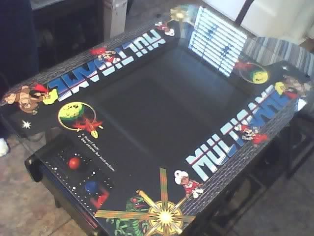

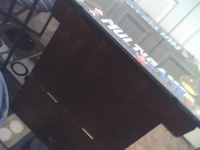

its not hard to build at all. dont listen to these guys. here is my spin! here are before and after shots using the plans for the midway mspac cab on mikes arcade! As for the monitor we used a nice lcd from Japan. it is awesome and plays great! The last 3 pictures were taken with my cellphone so sorry about the crap quality!
