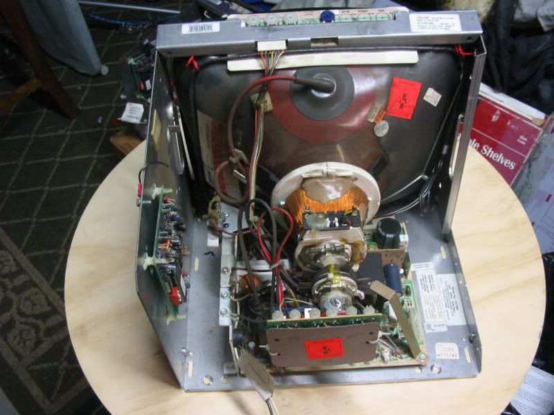

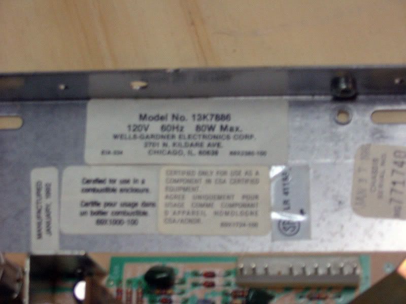

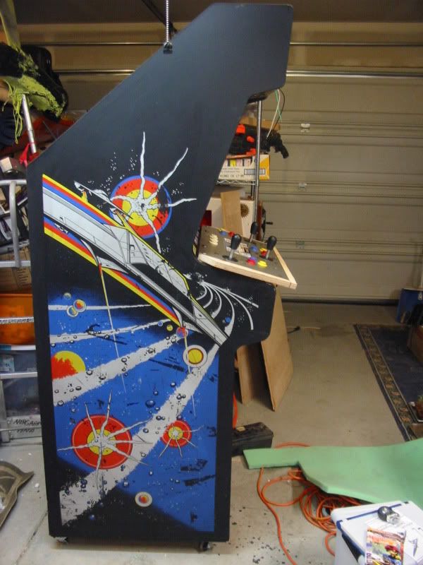

Hi I'm new here and new to building arcade machines. I have a Wells-Gardner monitor, model number 13K7886 (I have one with a touch screen and a couple of others that don't). I have no experience whatsoever on monitors and unfortunately, there is no one to take it to in my town to get this thing hooked up professionally. I can't seem to find a manual. I need to know everything I can about this so I don't blow anything up by accident. (esp. what is an isolation transformer? Where to get it, how to hook it up, etc.)
Can anyone point me in the right direction? Pictures would be the most helpful and if anyone knows what other parts I might need and where I might be able to purchase parts online for a JAMMA machine.
Thanks

The cab I'm using is a completely empty Atari Asteroids arcade cabinet that I saved from going to the dump by the previous owner it has nothing in it no power supply or any wiring no speakers no nothing.
The game I what to put in it is Capcom's Alien vs. Predator it is a CPS2. I have a jamma harness and some other things already.
here are some pics
The monitors are not broken or out of order they are still relatively new.

Yeah, hooking up an arcade monitor is really straight-forward. Just hook the Jamma red, green, blue, sync and video ground to the input header on the monitor, and supply power through an isolation transformer. Pinouts are all in the manual.

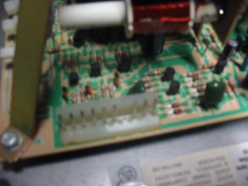

Regarding your pics, you see the pins where there are a row of 6, a space, and then a row of 3? Orient the monitor so you're looking at 6+3, from left to right. Then your connections go red, green, blue, video ground, positive vertical sync, positive horizontal sync.
Next, the 3 pin header is video ground, negative vertical sync, negative horizontal sync.
I assume at this point you've figured out the AC power and earth ground connections. (use an isolation transformer)

The manual has pictures. Attached to this post is a screencap from a part of the manual, with the pinout of the monitor's interface connector

There is LOTS of information out there. It is not hard to find. Speaking of information that's not hard to find, here's the pinout, straight from the manual that Ken pointed you to earlier.

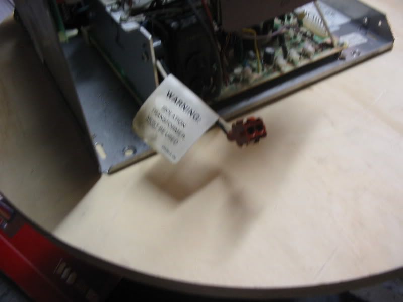

I see that I know that is the video part of the monitor. The part I'm looking for is a picture of what the isolation transformer looks like and if I need to add plugs and wires in to it I need to know what they look like and the names of the types of plugs and wires for the connector piece.
Hey everyone learns in a different way but spoon-feeding is the first way we all learn how to eat by ourselves.
yes I see that I know that that is the video part of the monitor the part I'm looking for is a picture of what the isolation transformer looks like and if I need to build one and the name of the type of plug for the connector piece
Ah. OK. Sorry - I wasn't sure what pary you were having trouble with.
An isolation transformer is a 1:1 power transformer. 120vAC input, and 120vAC output. Arcade monitors must always be powered through an isolation transformer, as they are "hot chassis". Not using the transformer will result in destruction of several components in the monitor's power supply section.
An isolation transformer is a standard arcade part. If you do not have one, you'll need to get one. It's not expensive, maybe $15 brand new from Bob Roberts or something, or you can post a WTB in the trading section here, I'm sure someone has a spare they'd sell cheap.
The connector on your particular monitor appears to be an AMP connector, but the type is not important. If you can't find a connector that mates with it, just get a pair of matching, mating connectors, and replace the one on the monitor to match your installation. Two pin Molex connectors are commonly used on arcade monitors, and I believe they area available at Radio Shack.
The monitor accepts 120vAC on two wires (no polarity), which go to the output of the isolation transformer. If the monitor has a green wire coming off the power connector, tie that to earth ground, which goes to the third prong of the game's power cord, as well as the metal frame of the isolation transformer. Many monitors don't already have a ground wire, since it's pretty standard to simply bolt one onto the metal monitor frame.
-Ian
Oh, almost forgot - an isolation transformer looks much like any other transformer. It's exact appearance varies from game to game, but it's an iron block the size of a coffee mug with four terminals - two input, two output. No polarity on either side. The wires simply solder onto the transformer's lugs. Some transformers have more taps - it's common for some games to have extra windings to power things like coin door lamps or something. Atari games used one BIG transformer that contained isolation windings as well as windings for supplying the linear power regulators. Standard "Jamma" type transformers will be simple and straightforward though.
-Ian
Ok thank you it's starting to make some sense to me now.
So I can cut off the AMP connector if I can't find the right type of connector and replace it with a pair of matching two pin Molex connector? Now is it best to solder the wires or do I use quick connectors like the ones from the control panel and joy stick? I'll have to go buy the isolation transformer from one of those places you mention.
