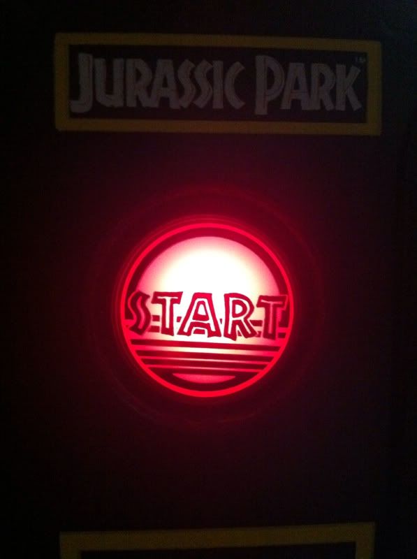

How do I remove the bad bulb behind the start button on my Jurassic Park?
Absolutely can not figure out how to get to the bulb in there.
If it's like other buttons of it's type, the White Mechanism with the switch and the bulb socket simply snaps into the back of the button housing. You just pull them apart. I know, it feels like you'll break it but that's what I recall.
I literally did this last night on my data east Star Wars and I'm pretty sure it is the same setup.
Yeah, just wiggle it out of there gently and it'll come out. It was more of a pain for me to get it back in and took some playing around with to snap it finally. An LED behind that looks sweet btw!
Thought for sure I was going to break it trying to pull it apart, but I'll give it another try this afternoon.
I pulled mine out and down a bit at the same time. Give it a good wiggle while pulling it out, should come out no problem.
You guys kick ass.
Yeah, the whole thing was a piece of cake. Was nervous about yanking on it before, seemed like it was going to just break right off. What a masterbatory response this turned out to be. ;)
