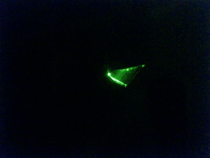

Because the 15 pin power molex from ZVG will not fit the power brick in the BZ mini, I decided to use an Asteroids Deluxe cabaret wiring harness which fit the brick and power pinout to the monitor. Then I hacked in the ZVG output connector to the z, x and y on the 12 pin molex input. The zvg has been tested and is known good. When I run battlezone in vectormame, I get a picture like this:
Does this look like the z and z being reversed? Anyone kinda recognize what a pic like this means?
