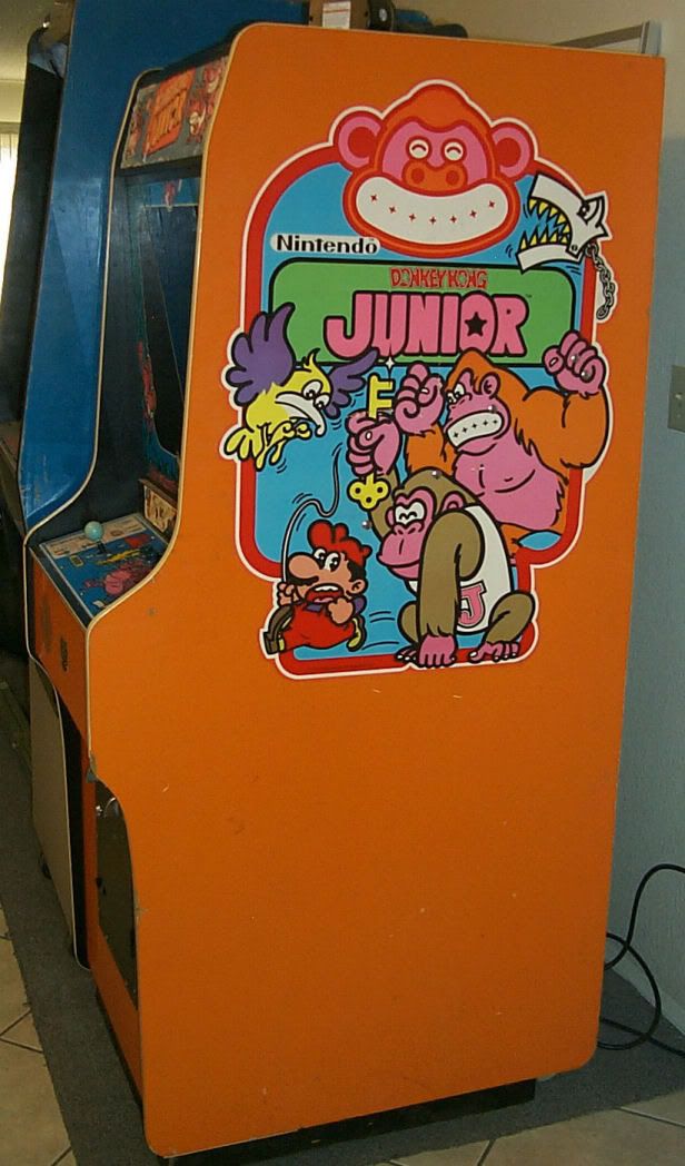

This should be fun. I don't think that is DK side art. Pink with black near the monitor bolts doesn't seem right. Wonder if it is Jr side art. There may be orange under that there blue paint.
It could be DK side art.
Mine has the monitor bolts through DK's hand which has pink above it and black lines for the outline of his fingers.
