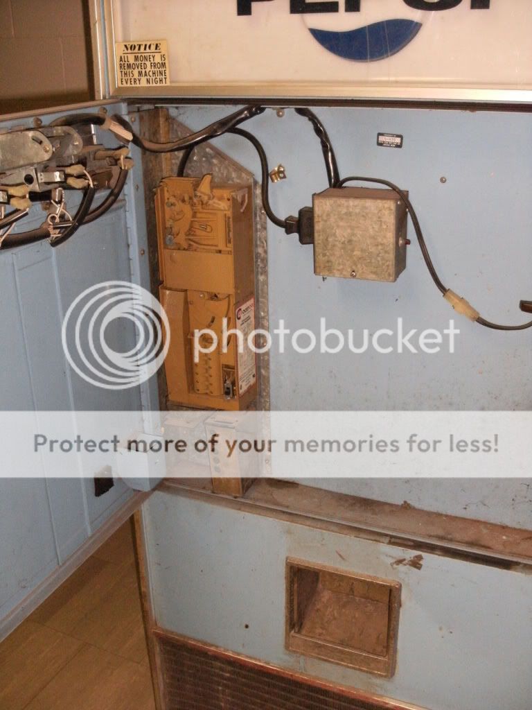

Here's what the inside looks like. In the bottom left hand corner is where the junction box is that the wires come from. Sorry this is not my pic.
http://s515.photobucket.com/albums/t357/ScaleBowler/?action=view&current=DSCF0751.jpg
The wires going up into the door feed into the fuse box type thing in the middle of the below image. The wire you see off to the right with the molex connector in is the wire that goes to the fluorescent assy in the top.
It is hard to tell from the last picture, but the red button on the side of the metal box looks like a circuit breaker. If it is, you may just need to press it to reset....
It should have some writing on it giving the rating (probably 5A or 10A) if it is a circuit breaker.

yep that it is- i pushed it 2x and nothing happened. I was going to put a wire between the connectors on the back of the breaker but wanted some opinions first.
