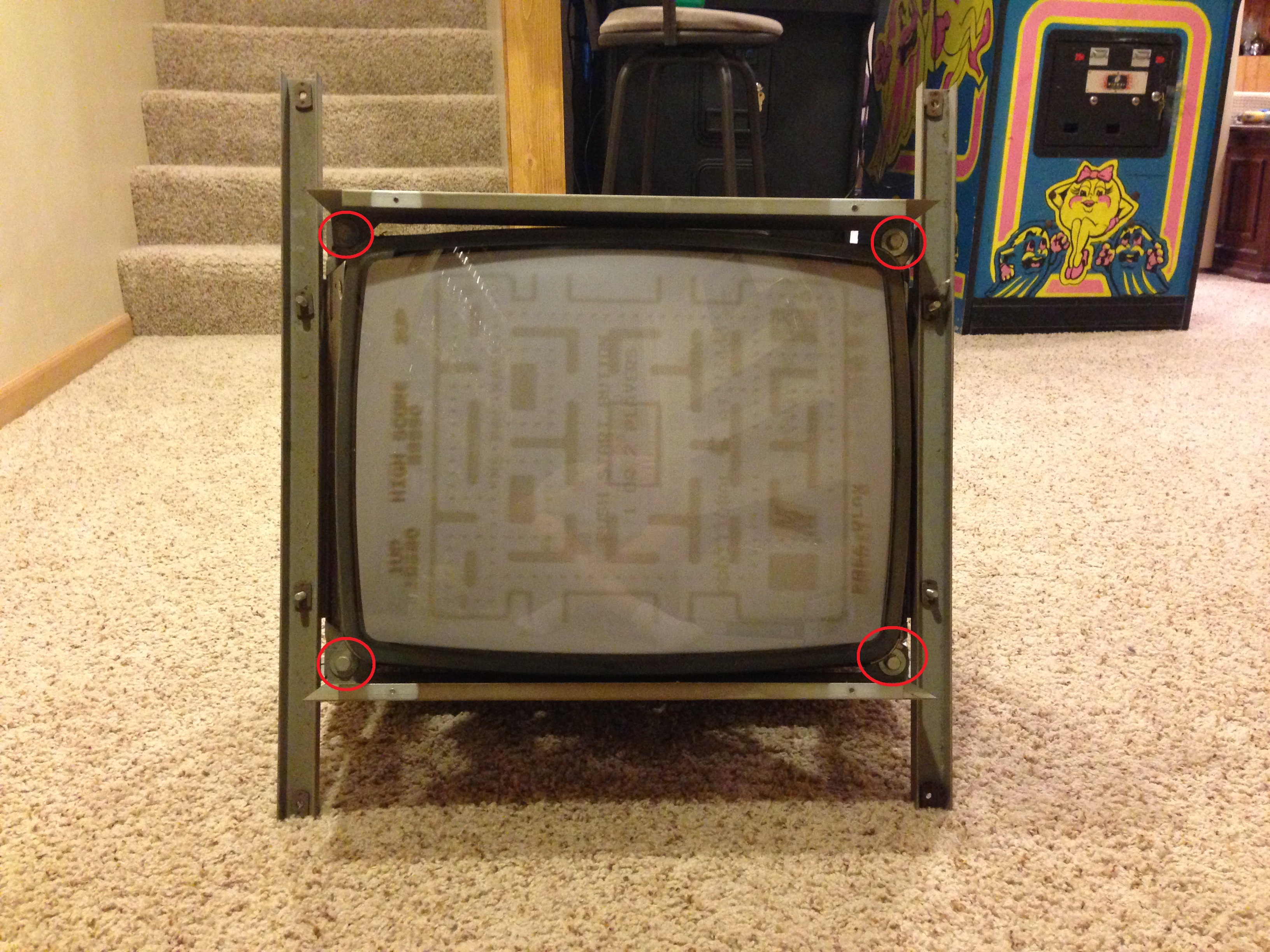

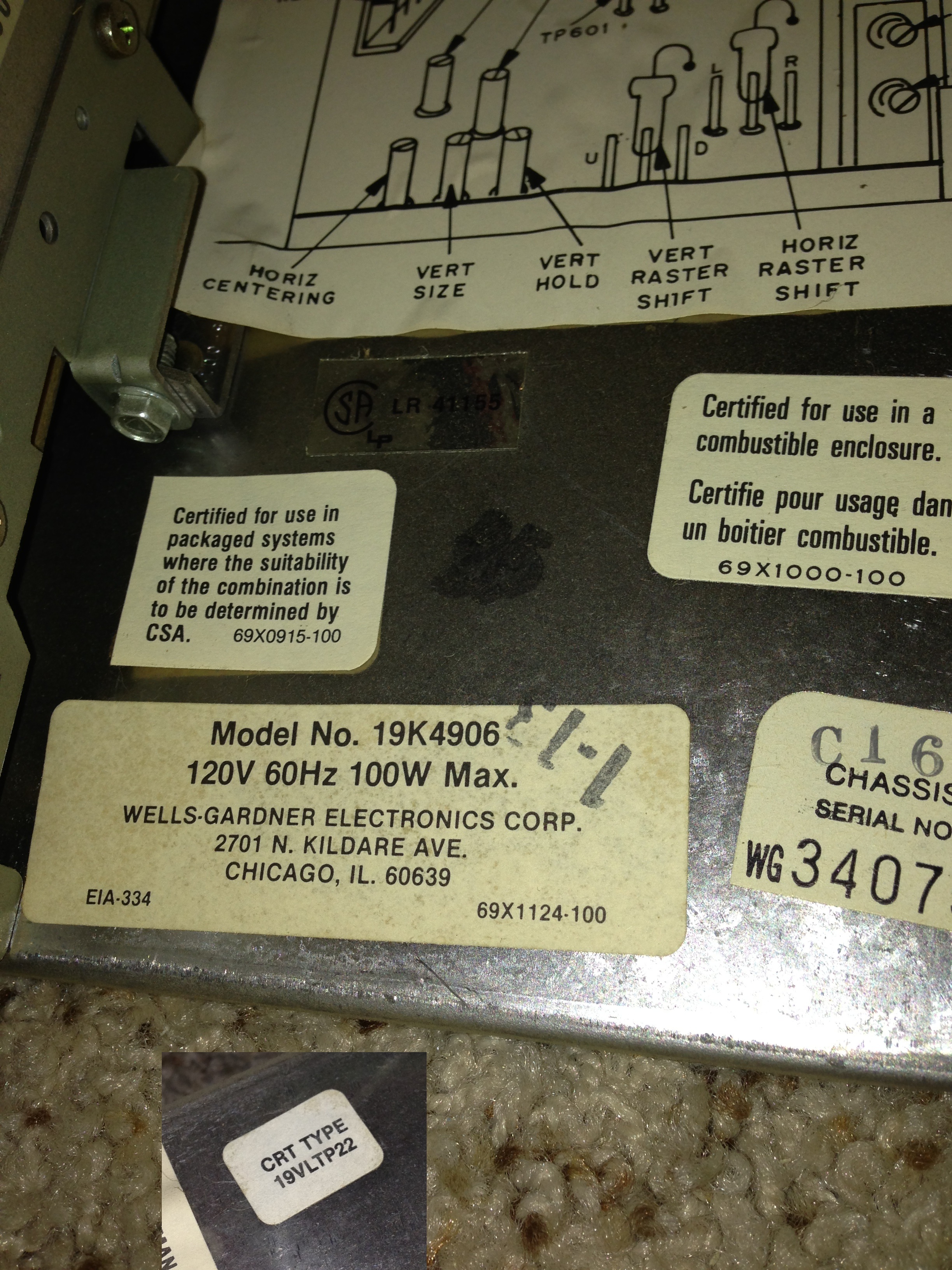

Ok, so here is my monitor. Some people have said that Ms Pacman machines used G07 monitors, but I think I might have heard them say that was one of the monitors they used, not the only one. Unless I am missing something, I don't think mine is a G07. Here is a picture of a few markings on the monitor. Pretty sure the "CRT TYPE 19VLTP22" is just referring to the tube. Looks like the overall monitor is a Wells Gardner 19K4906.
Here is a front view of my monitor. Man! Once you have it from under all that glass and everything it makes the screen burn in look SO much worse! If I'm following you all correctly, once I get the new screen, I need to put it inside of that frame thats all along the outside. So really, to remove the tube, I mostly just have to remove the four circled bolts in the picture below.

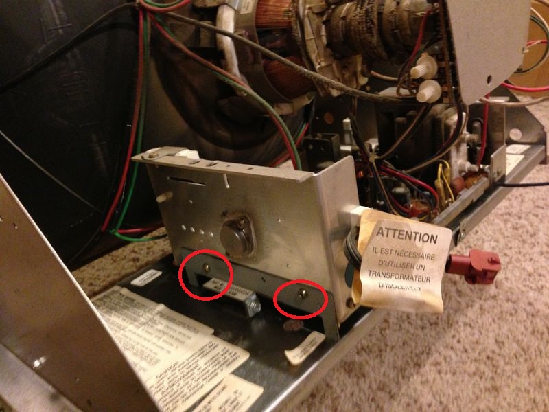

So then I assume I need to also remove this chassis board from the back of the frame as well? Or would I reuse this and just hook up the new tube/monitor to it? If I have to use the board from the new monitor, do those come in a standard size where they would screw onto this platform, to the two circled screws below?

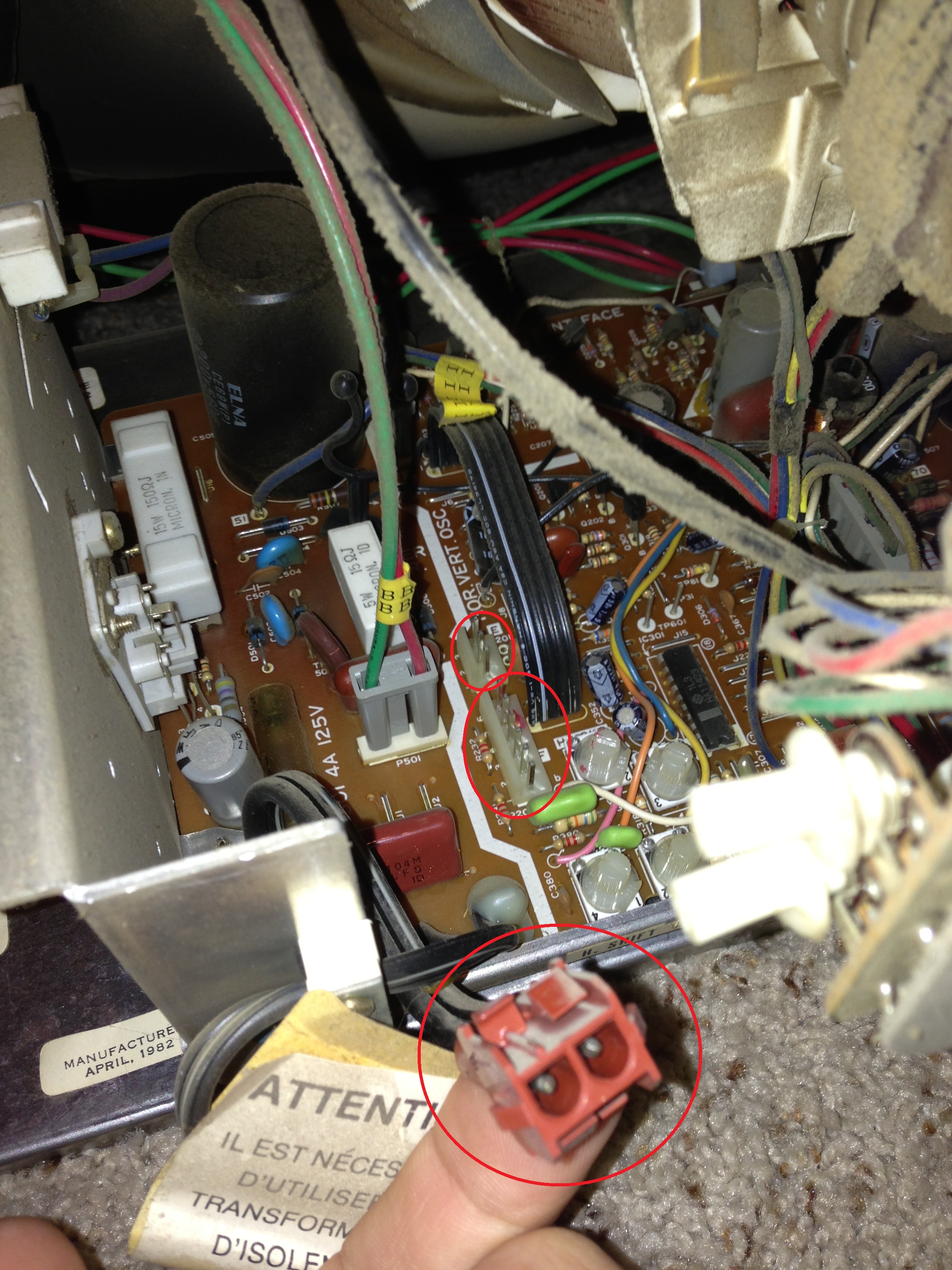

Looks like theres three connections I had to unplug to get the monitor out of the cabinet. If I have to replace the entire board with a new one, is that a standard thing, where those same three connection pieces will be on the new board as well?

A "complete monitor" includes the tube, chassis (pcbs), and the sheet metal frame with angled sides...
All you need from that if you're putting in another monitor is those two long rails, thats a mspac/midway part not a standard part of the monitor

G07 and wg4900 are both common from that era...

You can put a new tube on that chassis (if you can find one from a wg4900, but anything else is beyond normal (look up tube swap))
Or you can put your working chassis onto a broken wg4900 with a good tube...
EDIT: or you can drop in a complete different monitor, ie a g07, without interchanging parts
The horiz/vertical issue was answered, ms pac has a horizontal-frame mounted sideways... to see a vertical-framed monitor click q*bert in my sig
Lastly, no those two screws are not how you remove the chassis, the single screw below them (parallel to the yoke)

Small correction, the two smaller rails on the long edges of the monitor are also midway specific parts to hold the tinted bezel, so you might need to transfer that to your new monitor too
And as for your connections, they are standard as far as power/signal but the actual molex connector for power might be different and need attention... And the two signal connectors are spaced differently wg vs electrohome or others, but you'll figure it out, just look up the pinout
Ok, so I think that answers lost of my questions. Just one left. Are you saying that if this other horizontal 19 inch monitor is not a G07 or WG4900 then it won't work? If its some other model will it have those same three connectors?
Short answer, it probably will...
That is if its low res, color, raster, not sanyo/nintendo
Most are...
My advice, don't waste your time with a matsushita (sp?)
