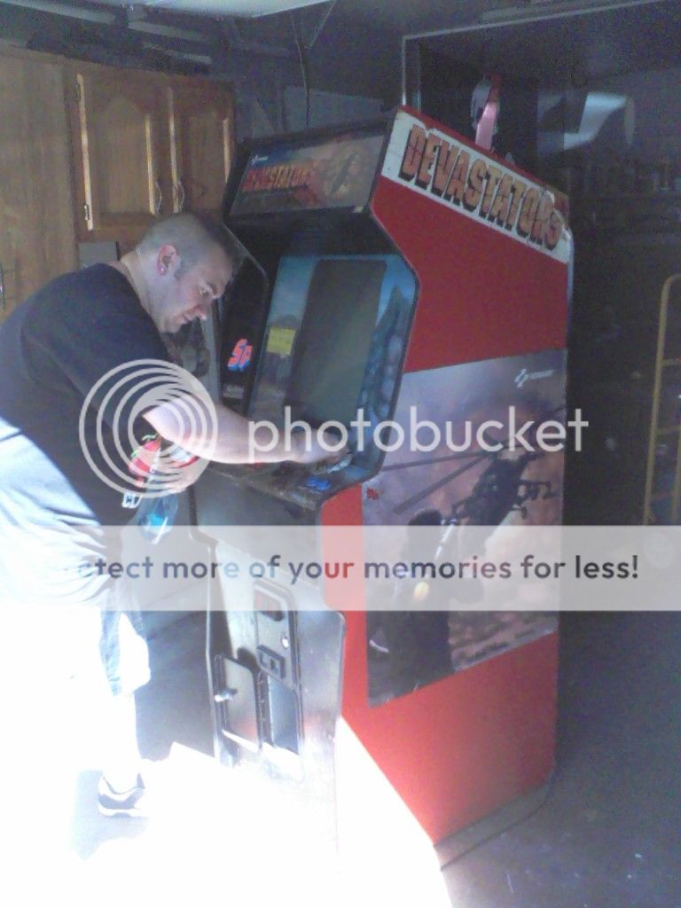

It was a great adventure that day! Yes I was excited to find that the Devastators game was actually working. Thou I need to identify the monitor chassis. I'll make a thread on that in the appropriate section. It really could use a cap kit. The artwork thou seems good in pictures was rougher then it seems. It's going to eventually become my 60-in-1 cab, since I want one out for the hangout space.

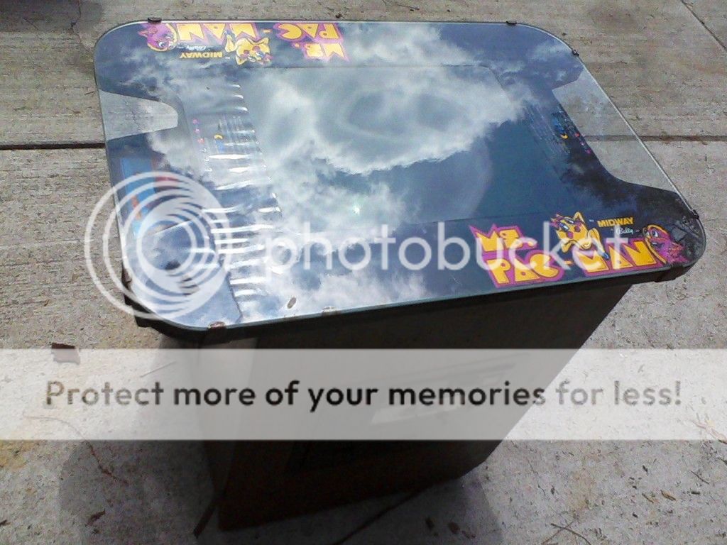

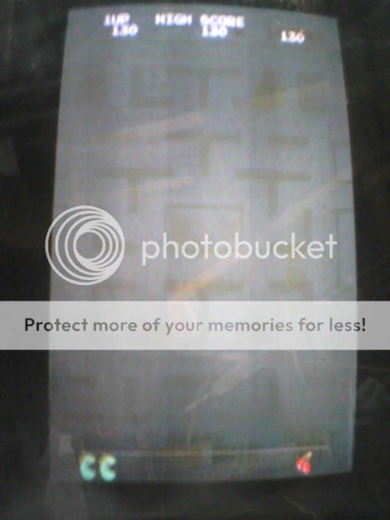

The second one, was a "mystery" cocktail, as it was locked and had no idea on if it was complete or not. TofuDrifter81 was kind enough to drill the lock out so we could all find out what was on the inside. It was complete! Thought we'd get lucky and plug it in. Monitor fired up, waiting.. waiting.. Nope no game.
Didn't think nothing of it till I had time today to do some testing. Pulled the boards from the cocktail, and plugged them into the upright. Which they ended up working. Graphical errors and such. The board has a speedup chip and a maze pack.
Went back to the cocktail and searched again, it wasn't just a fuse.. it was actually 2! She fired up after changing those and after some time most (not all) of the graphical errors went away, with me re-seating some of the chips.

The "unknown" Ms. Pac.
TofuDrifter, being the nice guy that he is, cleaning up the Devastators a bit for me. Or maybe it was because he wanted to play and actually have a decent control panel and screen to view?

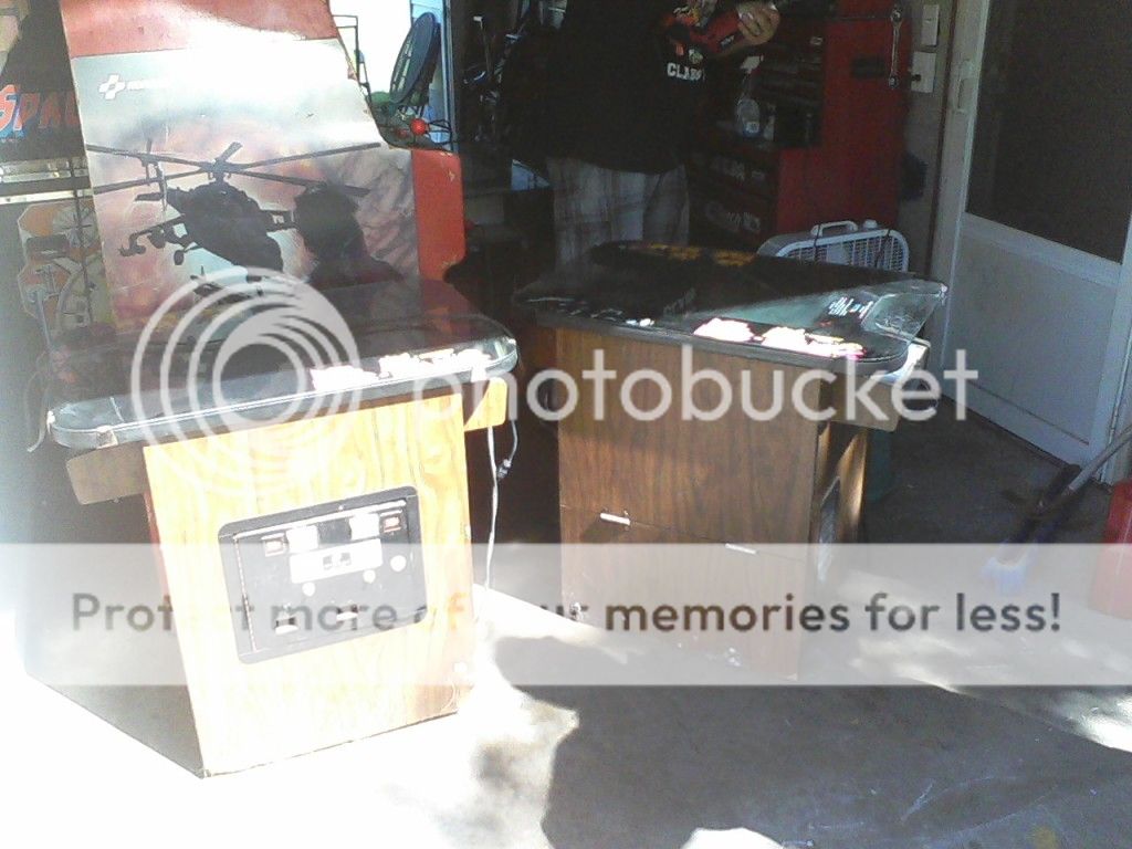

Here's the 3 cabs I ended up picking up, which I'm very happy with. All need some cosmetic work.

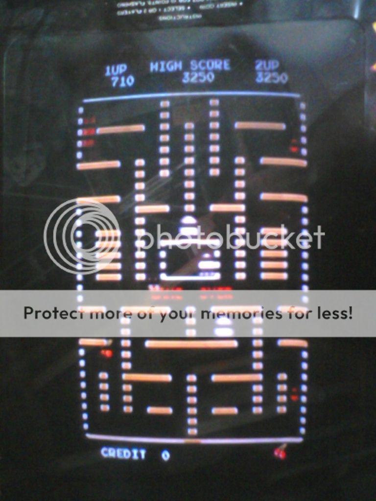

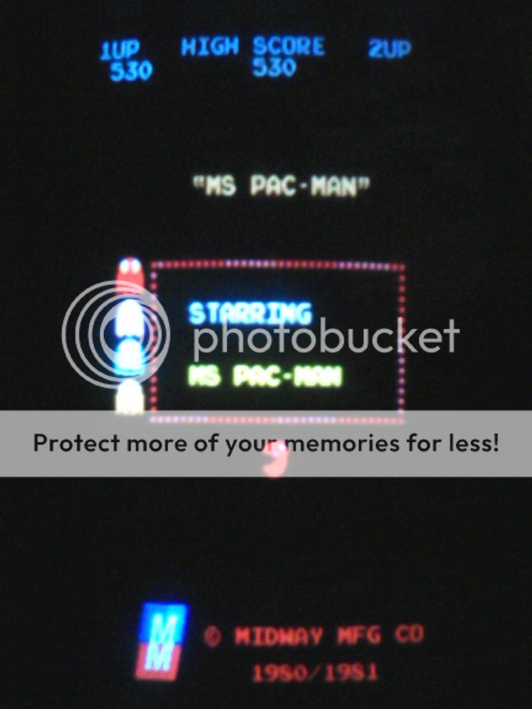

The next few pics are of the Ms pac and the graphical errors that I ended up having.. it started out like this..
Which then somehow happened to get to this screen next

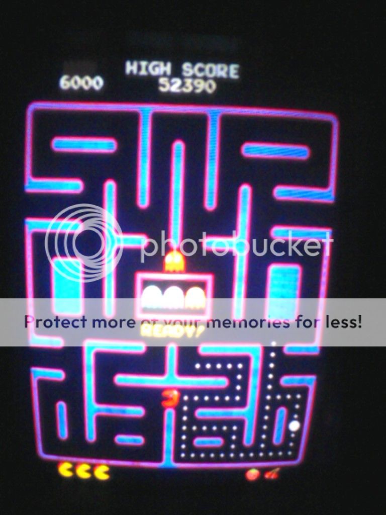

After pulling the board and doing a quick once over making sure things were connected and seated correctly, I now have this final product. A Red Ms Pac Man?!?!
After some research, I'll be checking around the 2A and 3A after work today, to see if I can't get Ms. Pac, and the ghost's back to normal. Still playable thou!
Speed up chip, and maze pack are installed, the neighbor kid and I spent a couple of hours playing it.
