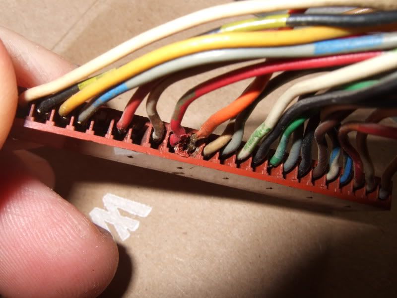

Guys, what happened here? Solenoid Board J3 connector. Orange and red wires seem melted?

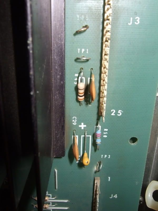

I decided that even though my 5v section was reading fine, I'd redo it. Replaced all of the components and no I'm getting a reading of .26 at TP1 and TP3. What do you think I did?
This is with J1 and J2 plugged in and no J3.

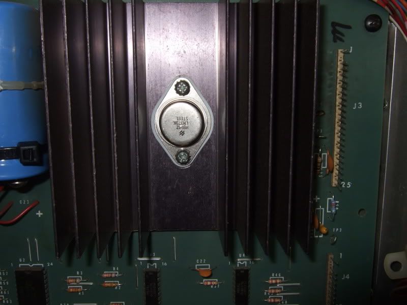

Also getting the same reading of .26 at TP5. My one concern was using that radial tantalum cap at C24 because the original looked more like a standard aluminum electrolytic cap?
Thanks for all of your help guys. I'll be a wiz by the time I get another Bally.
Yep you only need J3 connected to test both the High voltage and 5v on the solenoid driver board. Also make sure that the case of c24 is not grounding to the heat sink. It can be tricky to detect and you have to REALLY dig your lead into the heat sink to make sure. Once you have J3 reconnected measure your voltages and see what you get. If you still don't have 5V, check BR2 on the transformer rectifier board. Did you rebuild all of the connectors and headers on both boards??

The regulator semiconductor is not grounding to the heat sink. It was initially getting a .22 reading, but I adjusted the heat sink and it's good now.
