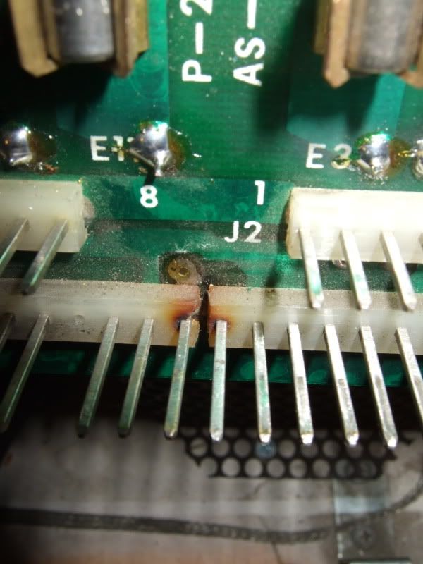

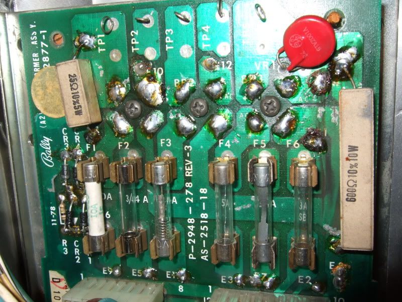

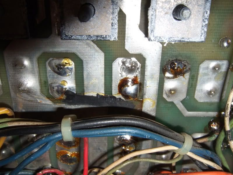

Oh, and pins 10 (dreaded orange) and 12 (red) on J3 on the rectifier look burnt. Only on the surface of the board, though. Not the actual pins or white plastic connector. There is a large glob of solder on the solder side at this point, however, so I assume this has been replaced at some point? Please keep in mind that I am not responsible for most of this soldering. The soldering I did do (the diodes) was a nightmare to begin with as all of the solder pads were fragile.

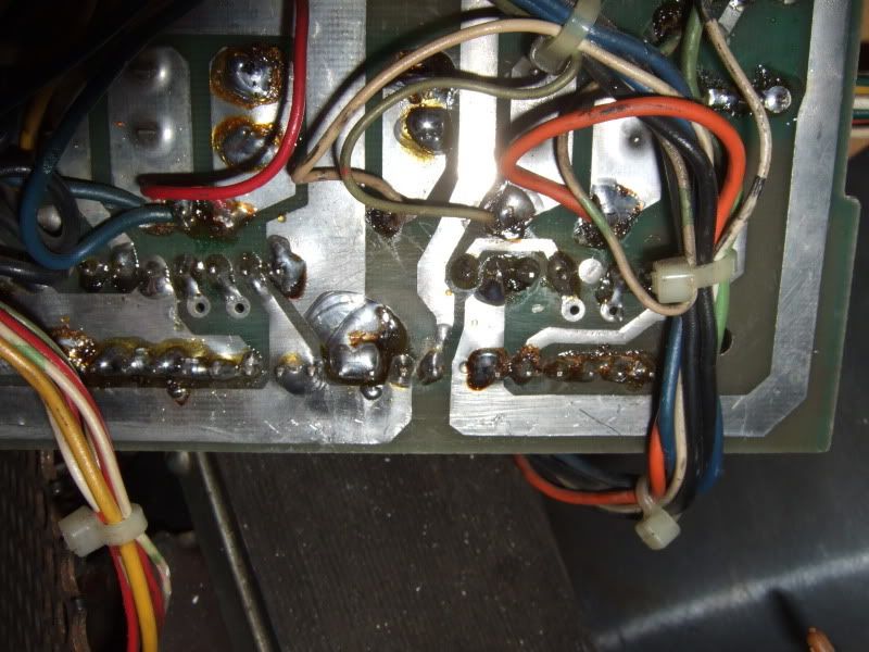

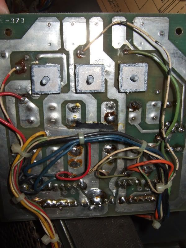

In order to have a reliable game in this vintage of SS Bally, you MUST rebuild those headers on the rectifier board at a minimum. You should also repin all of the connectors that attach to that board at a minimum as well. In reality all connectors and headers should be rebuilt for maximum stability. You may get in-spec voltages at the TP's but when you try to pass current through those burnt pins, you get resistance and less voltage.
The rectifier board is one of the easiest repairs in pinball to perform. Head on over to GPE and check if they have a replacement Bally/Stern rectifier board in stock. If not, email him and ask to be put on the waiting list. He builds them in batches...
In the meantime, you really need to address the bridge rectifiers - they are undersized for the job and probably lots their heat dissipating ability - hence the lockup after a period of time.

Anyhow, I've already emailed Ed and told him to let me know when he has a rectifier available. I just kinda feel like this one looks rough on my newbie eyes. Doesn't it? IN the meantime, I'll change out the connectors and pins to see if I can get it off the ground.

I decided to scrap rebuilding the rectifier (for now... I'll just take my time on it). I ended up grabbing a GPE rectifier board. Anything I should be aware of while resoldering the transformer wires? Ed's directions mention using a "high voltage" soldering iron while connecting E8 (2 black wires). Anyone know why?
I'm using a Weller WTCPT soldering station. I feel like that's high voltage enough. I mean, I can get out my Weller gun (<--sarcasm).

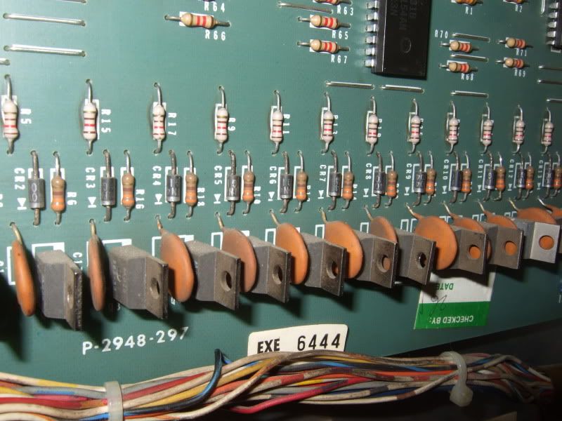

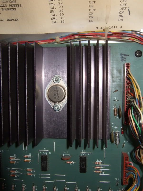

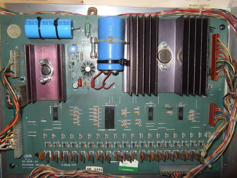

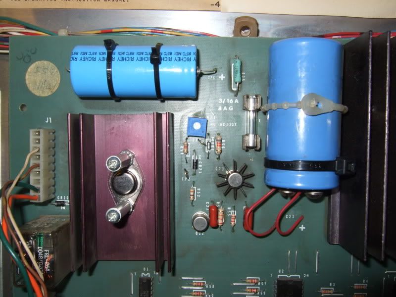

Did you rebuild the 5 volt regulator section of the solenoid driver board? Do you have an early or late solenoid driver board? Let's see a picture of it.
I rebuilt the high voltage circuit on the solenoid driver. It's the "newer" one with the fuse.
I'll snap a photo when I get home from work.
So then you did NOT rebuild the +5 volt regulator section. Sounds like all you rebuilt was the section for the score displays.
Ken - this is true. I'll get onto fixing the +5v regulator after I get this board in. I just figured I get a new rectifier board and take my time rebuilding the old one. There will probably be more Bally pins in my future...
Here's my SDB:
