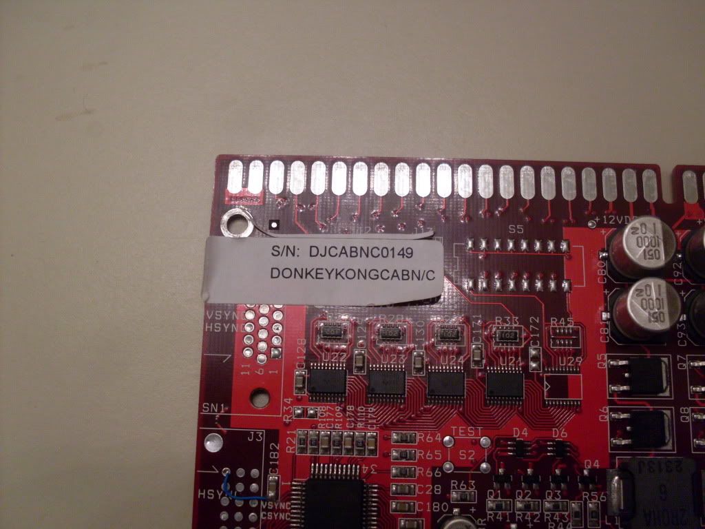

Well, last week my boss (who is a pinball expert but not much knowledge of arcades) went on a service call for a lady who had one of these that didn't work:
Well, he checked the wiring and power, but it wouldn't boot up. As this is all surface-mount, and I think the game was bought at Costco or something, repair was unlikely. He talked the lady into just converting the thing into a 48-in-1, which I get to do next week sometime.
Anyway, he gave me the board, and I brought it home and messed with it - not really hoping for much as it was dead on my test bench, too - when something I did got it to boot up! It seems that some of the chips on it are overheating and causing it to reset at this point. If I use cooling spray or keep a fan up close and personal, it runs just fine. Dunno if I should add some heat sinks or just put some fans on it.

Does the big black and green chip in the 1st pic run hot? The problem might be bad solder joints in the BGA solder pads (a b*tch to fix...). OTOH the stuff at the upper right corner looks suspiciously like the power supply section of a PC motherboard (especially since its right next to the JAMMA power pins) and the caps often go bad on those. Replacing SMT caps is a pain but it can be done with something like a Chip-Quik kit.

Does the big black and green chip in the 1st pic run hot? .
Yeah, that chip is getting pretty warm to the touch, as is the other big chip and the slightly smaller one a little above and to the left of them.
I'll see if I can pic up a couple heat sinks and apply them. Problem is, once they're on, they're on for good.

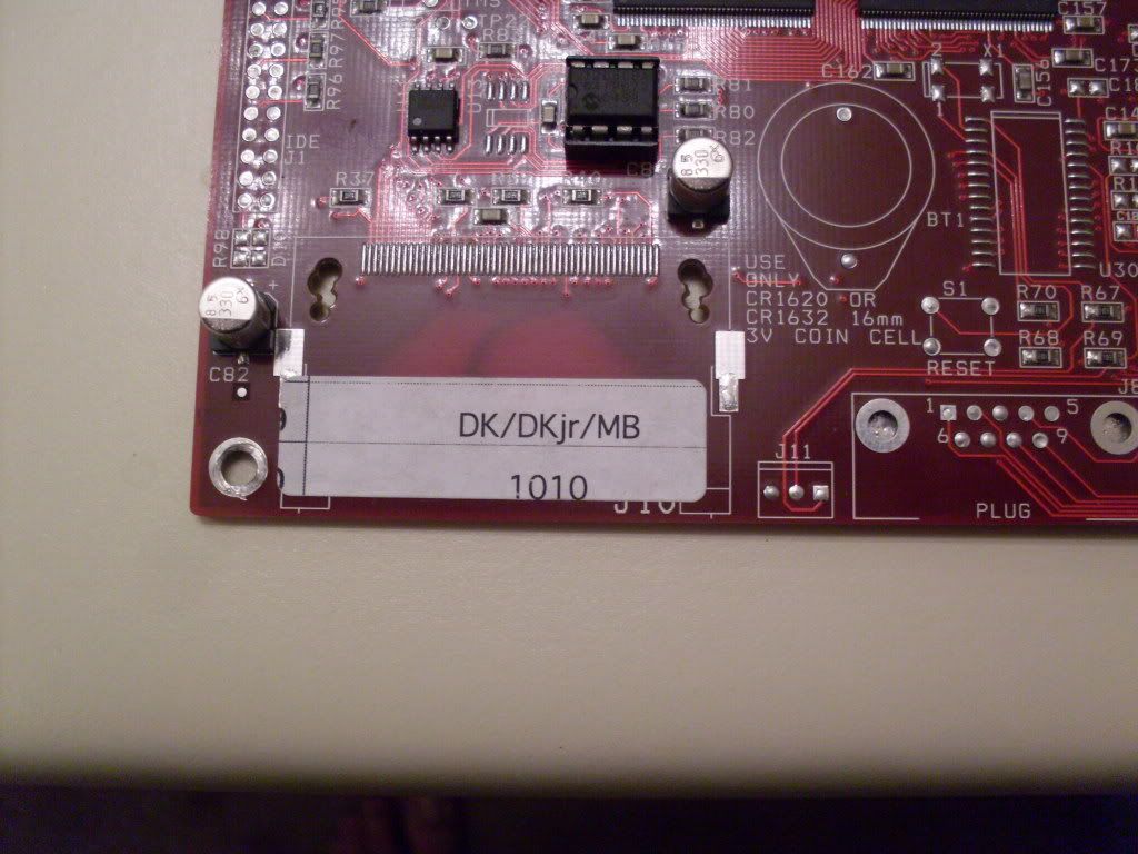

On the back of the board, it says:
*LUNA* Rev. 1.0
(c) 2003 Cosmodos, LTD.

Thanks for that. No results on google after a few searches. Looks like an interesting board for reversing and looking into how it works.
ie; what is the harddrive interface for? serial port missing the controller.. and the vga controller
Also the jtag port for the 2 tsop flash memory could be interesting to dump
