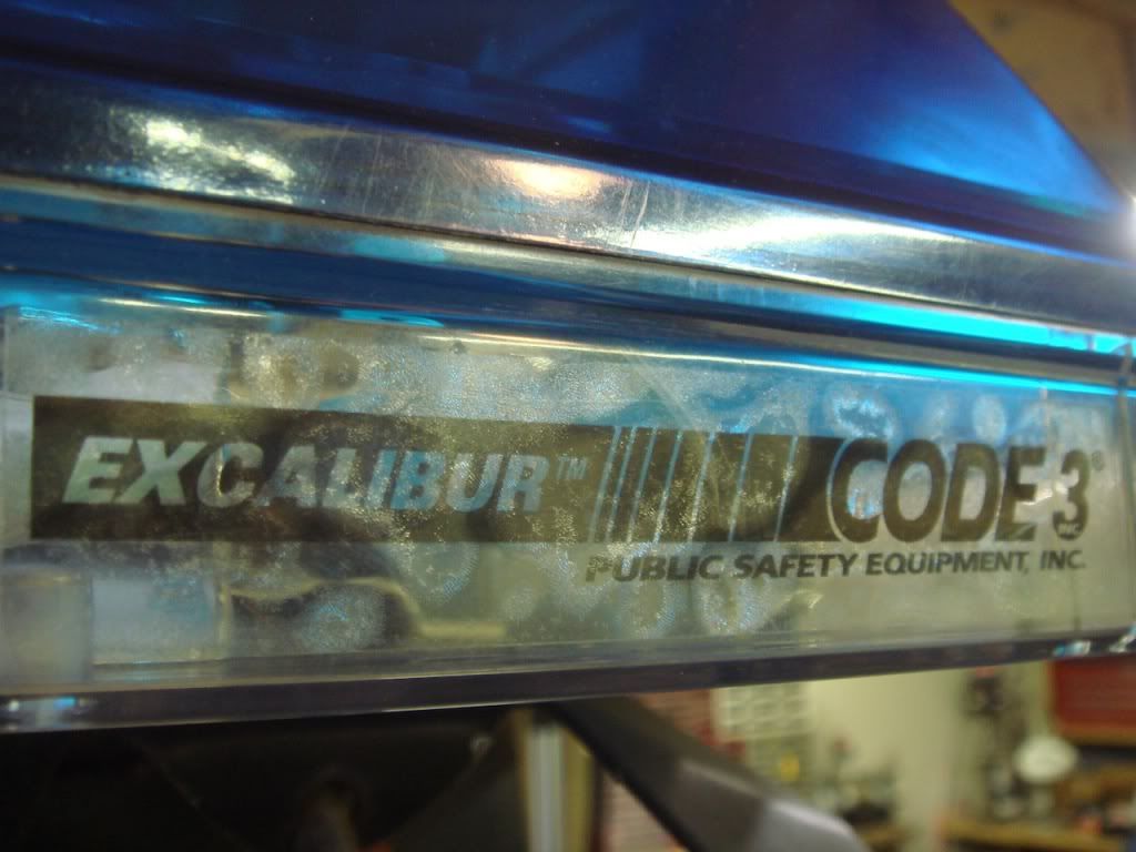

So I'm starting down the road of modifying the High Speed beacon light.
I don't have the proper size red cover anyway, and why on earth did Williams choose red??
I thought this would be cool, curious on thoughts?
Anyone else ever do this?
I have seen LED flashers, but something is always cool about rotating beacons.
Might add LED's too, but I think it's gonna be too much.

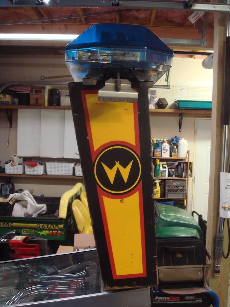

Got two problems with the full length bar:
-Space is the first issue, shortened it will hang about 3-4 inches past the sides, long it's 10-12 inches over each side.
-Power is the second issue, that 5th spinner is a concern. The fuse is blown in my DMM, so I haven't measured the current yet. I have to stay under 10 amps 12vdc to do this mod with the supply I have. Buying a bigger supply isn't an option for me right now.
The really nice touch is that the power supply I have has a remote input for power, so I should be able to do this without relays.
The video is without the center spinner running, so it's still a pretty sharp looking light.
I have a LED flasher as well, but I'm not sure if I'll be using it or not.
The red dome shown on the machine is way oversized and really isn't an option to use.
I have $30 in the light bar, can't remember what I have in the supply as I got it so long ago.

I will not be cutting anything, so "original" can be restored easily, no pinball machines will be harmed!

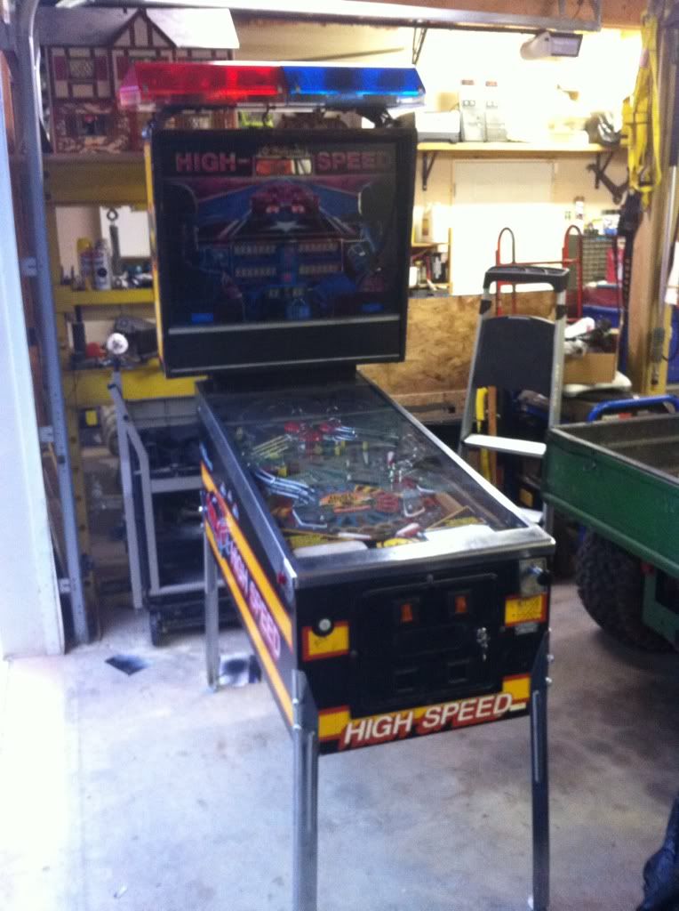

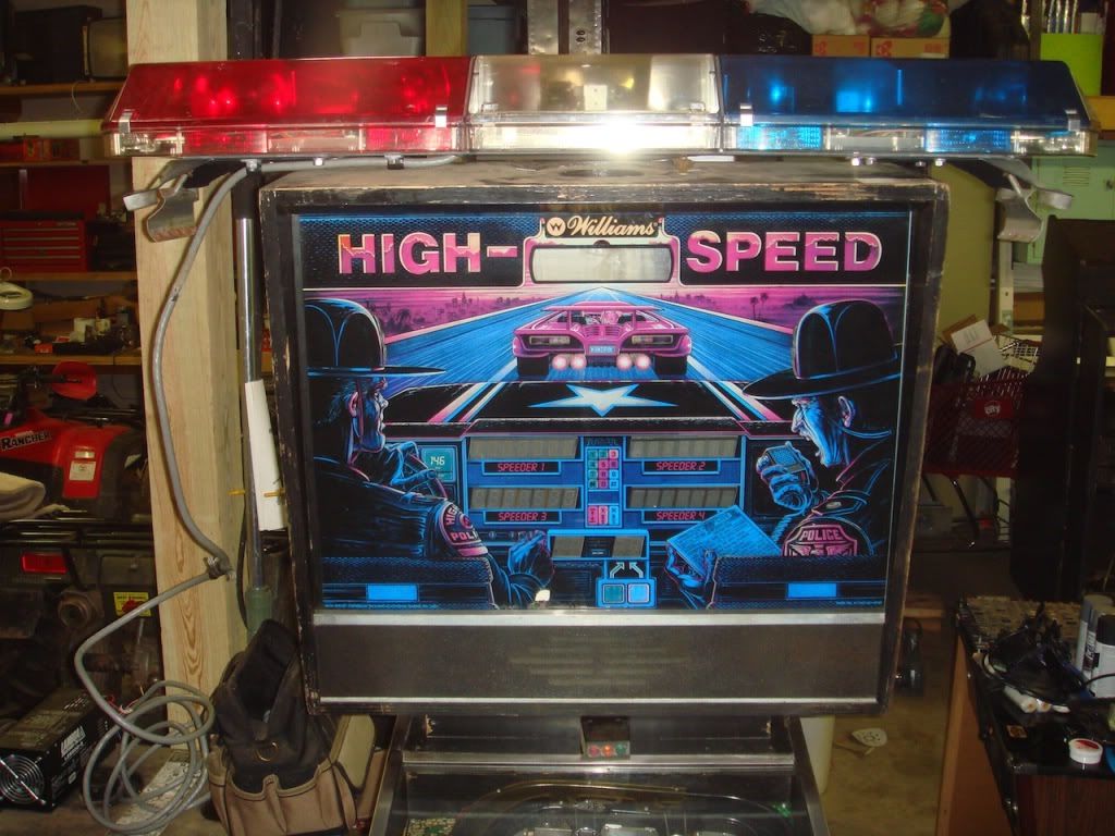

The new light is shaping up to be a pretty sweet addition.
That is awesome! Cheap too! Any pics of it working/mounted?
Took me a week to get the machine working (mostly) but it at least plays now.
Now for some pictures of the bar (full size) sitting on the machine head.
I still plan on removing the clear center section to make the bar shorter.
The video shows it working, I'm running it off a side supply just to demo.

Worked on the light bar tonight stripping off all the un-needed lights.
Will shorten the bar this week to remove the center clear section.
Finished!!!!

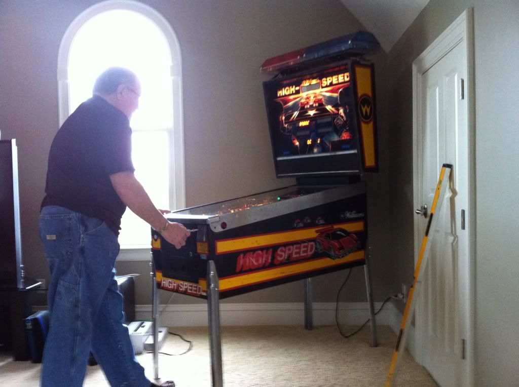

Well, finished the machine last night (finally!)
Just in time to deliver it to it's new owner this morning.
I really regret not shopping it and doing this mod sooner.
HS is a truly enjoyable pin when it is working well, and I didn't have it working well until I got it shopped and inserts leveled (they were really raised up!)
But, TAF came and others had to go, this was one of the casualties.

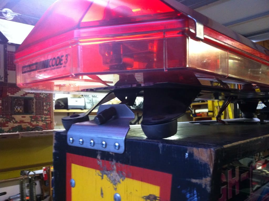

Overall, the light install was reasonably easy to do, I had to rewire the supply voltage to the topper, the old one used 26v AC and the coil I used to power the supply for the lights was 12v DC.
Simply tapped into the 12v circuit and used it to supply the 60 mA for the relay.
I did install a large 12v supply to power the lights, needed about 10-15 amps of 12v DC to run the 4 spinners. These are the original police bulbs too... super bright!!
The original roof mount worked great to attach the bar as well.
I was worried it would blind the player, but it is out of the line of sight when your watching the playfield and it really brings the police chase feeling alive!
I would recommend this to anyone that wants the machine to look a little less aged and doesn't mind mods.
Cost was $35 for the used light bar (bargain bin price), and $26 for the power supply and $5 for a relay.

Another thought, the back box key is on the top of the machine, lower profile wouldn't let you access the keyhole.
