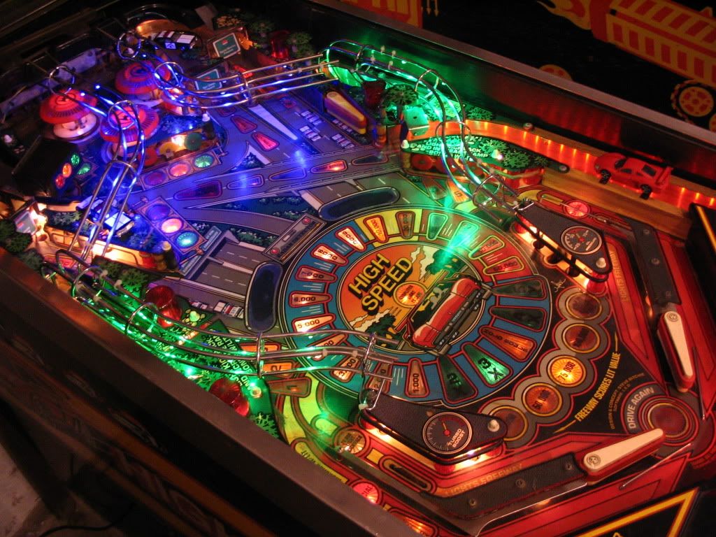

I thinking to make some mod of the two ramps.The mod will be with leds on the ramp(the leds will look from the uppers side of the rails to down-I will shout it in the pictures what I mean).Of course the work will be much longer because the ready led strips are too wide and will be too ugly when they are agglutinate on the ramps-the strip will stick out.So I will stick every led by led manualy on the rails.I will make some demo of this and will post pictures tomorrow.After finishing with the leds,I think to program PIC microcontroler with functiion when the ball go trought the begining of the ramps to make leds flash until the ball drop to the hole.
Thinking about to slow down a little the light power too
I'm wonder and for the colou of the leds.I think red or blue.The test will be with the blue,but I think the red will be good too.
I compare the leds between this that the blue are cops second colour adn with the red will look nice and colourful,but the red is the original colour of the pinball and everything in red will be nice too
And the final the two little ramps after the long in upper side.I think the colour to be green(because the ball come out from the grass and bushes:).
Of couse if someone have a good idea can tell it

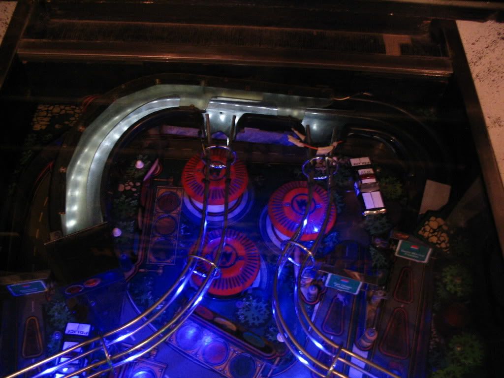

LEDs mounted:
I use termo isolation(the black one from the Tools picture) to isolate LEDs and resistor from the metal rails
In working position:
Connections:
GND connection
Power connection

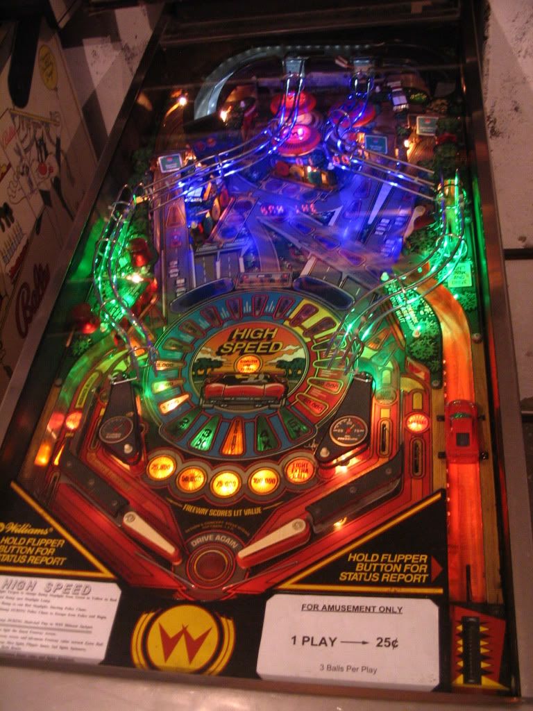

First test on constant light(must be slow down I think two times):
Very interested in the final product. I love the originality and creativity of the people here.
I am guessing one side is red, and the other is blue?
Great work!

I found the solution how to low down the light of the LEDS(this is for the BLUE leds,for the green I will test it today)
When I place resisotr 15kOmh-very low light
resistor 9kOmh-medium light
resistor 6kOmh-strong light
I will now place and the other LEDS for the other three ramps,and after that I will replace the ramps on there places,and find the wat how the wires will go through the playfield
