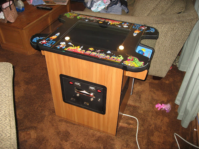

Hey.. I actually finished something (48-1 cocktail)!
Being very good at getting things to 90%... not so good at the last 10%
I'm pretty chuffed that I followed through and finished this one
When we met... this guy was a poor converted and tossed aside capcom bowling. I picked it up for a great price ($50) from a fellow KLOV'r complete except for a coin door.
- I stripped it all down, sanded and filled the divots.
- Recovered the sides (using the $20 vinyl from parts-express (which,
although not as good as the "good stuff", worked out well IMHO).
- Repainted all the metal parts.
- Built new control panels (using panels from arcadeshop)
- Replaced the monitor with a 19" PC monitor (save the 4600 for a classic).
- Installed a new harness and power cord ($15).
- Installed some blue CCL lights to light up the control panels.
- Installed a new underlay (from Phoenix Arcade, as were the CPOs).
- Got a new tempered glass top ($60 from a local glass company).
- Installed clear corner guard along the bottom edges to protect the
corners ($5 from Home Depot).
- Put in a 48-1 board..
Almost like a restoration, but not (obviously)...

Congratulations on getting something 100% done... I'm jealous!
