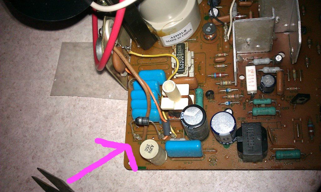

Got a very clean burn free G07, but had a blown HOT, replaced the fly and the hot , tested the regulator and small fuse and replaced. I then noticed this diode soldered in at S1 to S3 on the wires going to the hot. Never seen this, now the previous HOT had NO markings on it, just a bottlecap tested bad, why would they put this diode here? Is it because the transitor they used was not spec? wtf?

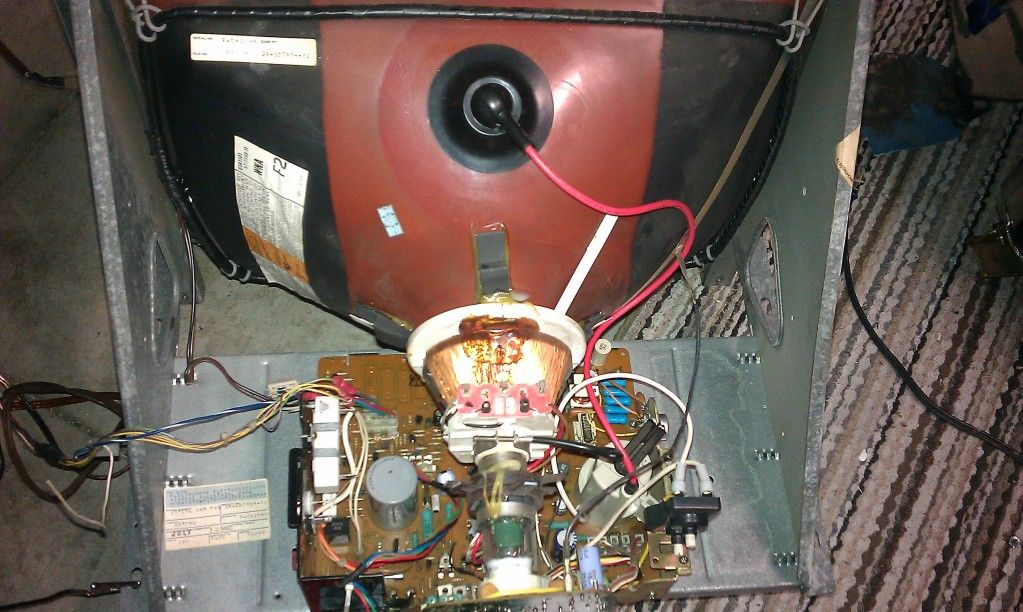

Well, I removed it anyway, this is probably the nicest burn free monitor I have ever seen in a game, like it was in a time capsule. Not dirty, appeared NOS really,It had a cap kit done on it and I imagine that is when they did this mod, but I removed this and tuned in the monitor, quite stunning really on my tester. This is going in a supposed HUO Solar Fox I just picked up, its really beautiful and Im shocked it was preserved as such, more pics...
