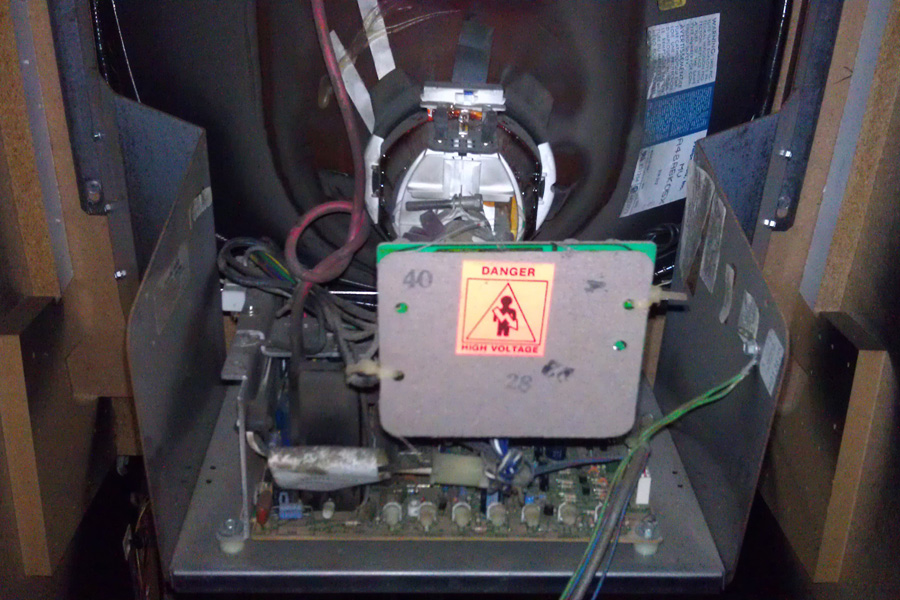

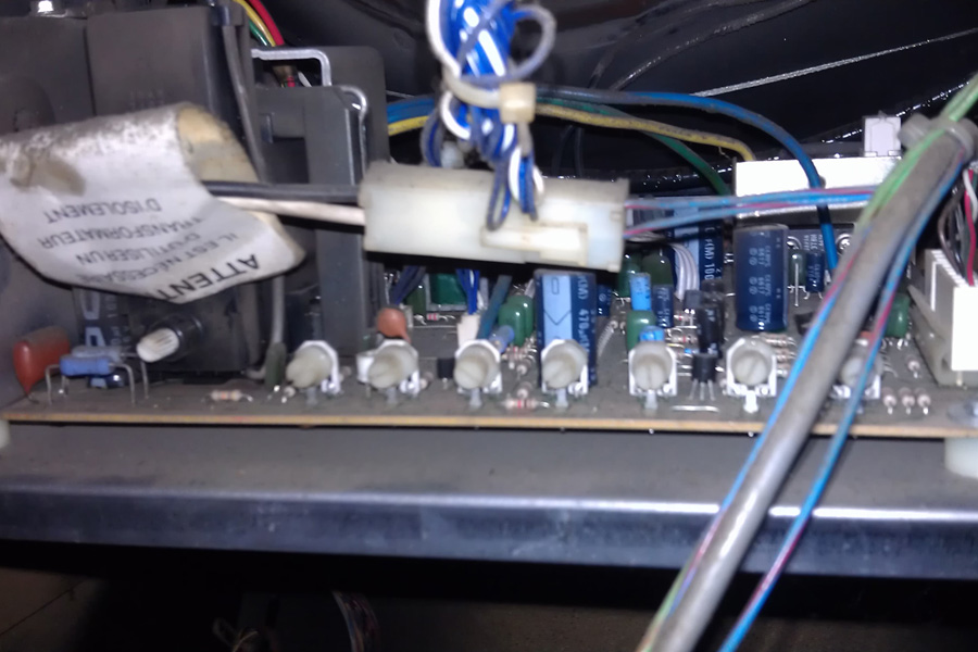

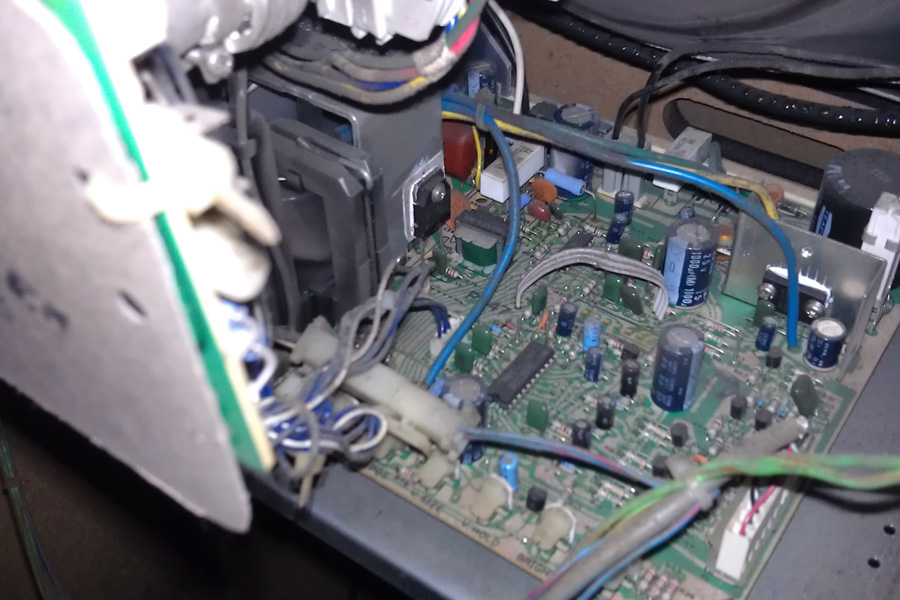

I have a Double Dragon machine I think it has a K7000 monitor but I'm not very good with identification so here are some pics:

The picture on this monitor is perfect, it's bright crisp, has great colors....
the problem is after an hour to hour and a half the screen goes completely blank. If I turn it off and leave it off for a few minutes it will work again when I turn it back on.... so I'm assuming that something is overheating...
I decided the other day I was going to try to watch and catch it in the act, unfortunately I had to step out of the room and missed it :( but I did notice that at one point during that hour the screen rolled vertically once and at another point the screen collapsed into a single vertical bar for a split second and then fixed itself.... I'm not sure if these two one time occurrence/split-second oddities are related to the monitor shutting off.
So anyone have any ideas as to what could be causing this problem?
Yup, you've got a K7000 with what looks to be factory caps or old caps. Could also be cold solder but it wouldn't hurt to cap the board while you have it out.
yup guaranteed you will need new caps and a fly and a good re-flow.
that chassis is old and needs a tune up.
and it is a K7000.
