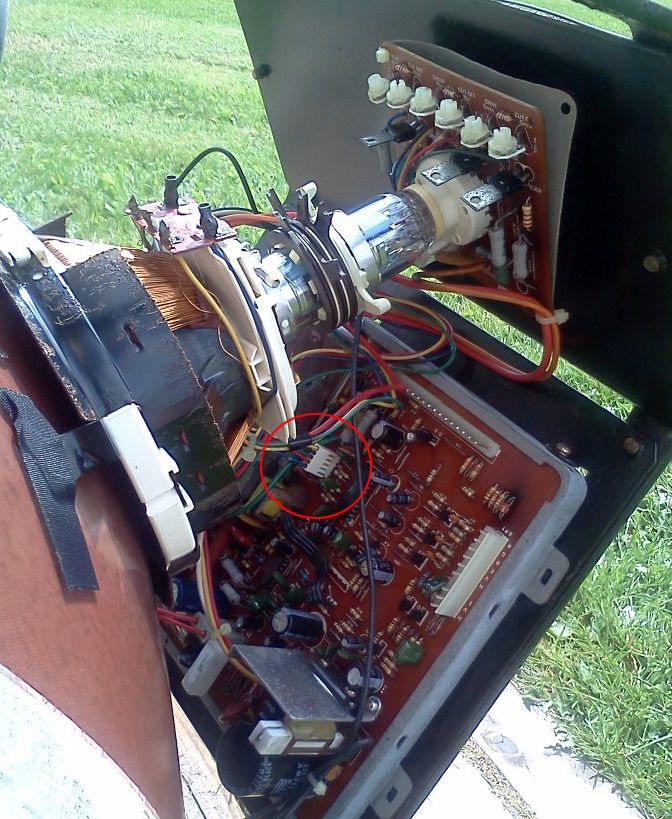

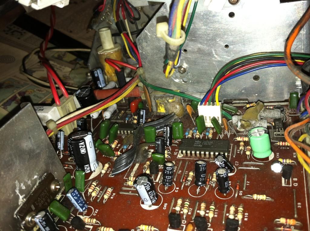

Hi there, after some years I´m finally about to finish my cabinet. Hopefully tonight.

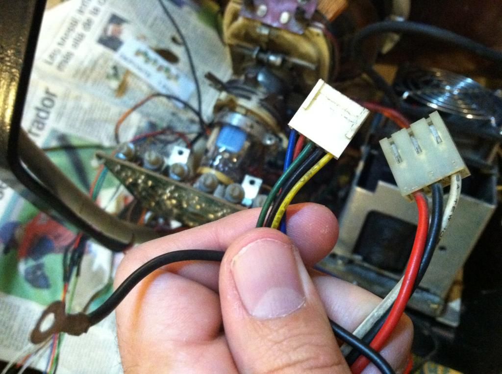

After recapping this Kortek board I left it for quite a while without attending and now that I´m about to connect it, I can´t figure it out where to connect this last connector.
It comes out from the yoke with a smaller one and a ground cable. It has three cables, one red, one black and one white.
I know it´s a silly thing and I´m sorry, but I would really appreciate it guys if you could help me with this.
As you can see in the pictures, you can clearly see where the "smaller one" goes. (I think is some sort of RGB maybe?)
But I still wonder where the other one that seems to be an electrical one, goes.

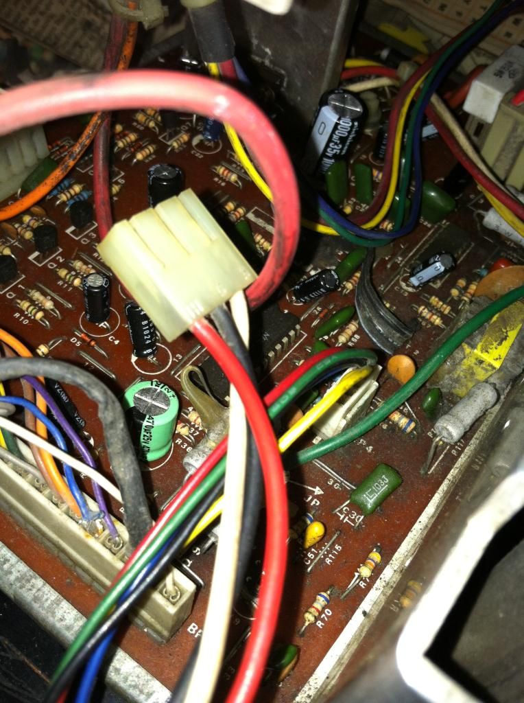

Here you can see where the other connector that comes with the same cable connects in a very simple manner to the chassis.
But as you can see, the one I´m having trouble figuring out where to connect, does not appear on this helpful picture. I can´t seem to find any way to connect it to the chassis with it´s three pin design.
