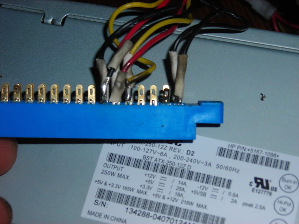

I am new to the arcade pcbs. I have bought five of the 1981 galaga pcbs and two of the "bootleg" pcbs. All not working. I have done lots of reading and have decided to go ahead with the Galaga renue kit on the boards with the older resistor packs. I am testing blind in that I have no monitor to look at. My hope is to install the Renue kit and power up the boards to hear some kind of sound. I have used an old computer power supply and a speaker for my inital test. Some boards made some kind of sounds and others were just dead. One question that is really bugging me, When I power up the boards will there be any sounds. I think I have read somewhere there sould be a boom from the sound chip.

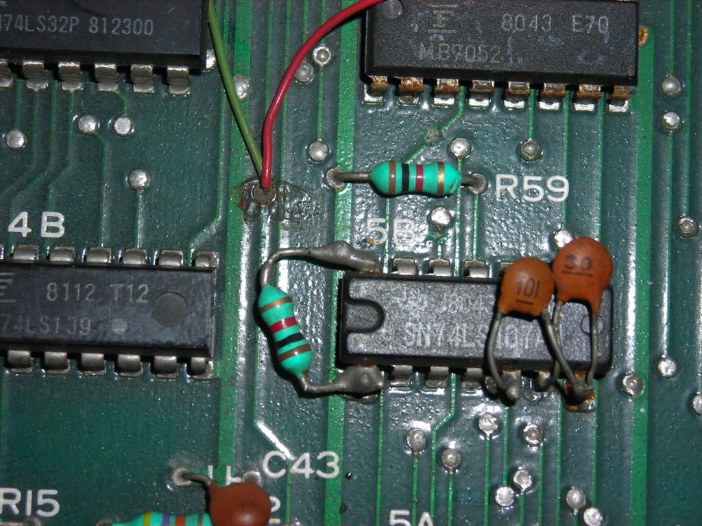

I just got done pulling parts off cpu board. Sockets and resistor packs and I have noticed some sort of repair on more than one of these cpu boards.
At chip located at 5b there is a resistor added to this chip connected pins 1 & 14. Also there are 2 caps added going from pins 5 & 6 to pin 7.
What is this for?

The one board I took the photo of will wait until I have something to check against. I am kind of intrested in why the caps and resistor was added. The other board that has been worked on same chip has only one cap. and that only goes to the pin 6-7.

You've mentioned that your 5 volts is at 4.85. Where did you apply that 5V wire to? What is your 12V reading, and where do you have that hooked up to the board? What type of speakers do you have hooked up to the board, and to what connector or pins? How many GND wires do you have running to the board, and to what pins and connectors are they attached? Lastly, do you have an edge connector connected to the board, or are you just attaching wires with alligator clips?

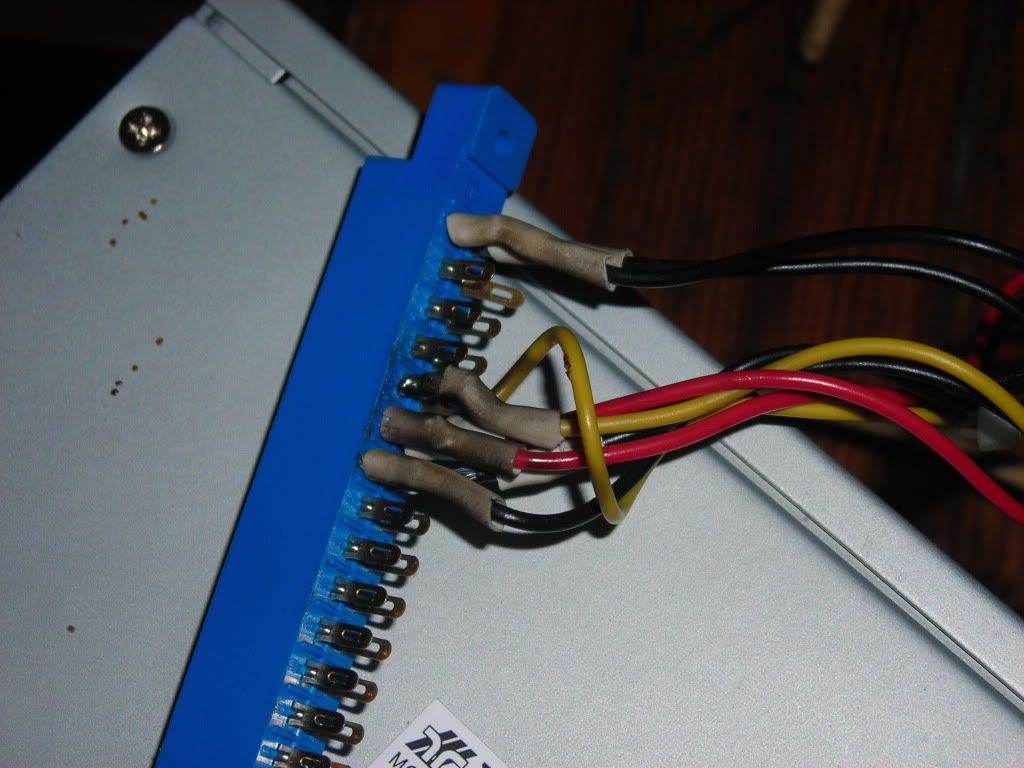

Very good questions. I have bought a 44 pin connector from mikes arcade and wired up an computer power supply.
pins A and 1 are grounded.
pins B and 2 are speaker and 8 ohm. B is the plus.
pins E and 5 are 12 volts and measure 11.6 on the meter.
pins F and 6 are 5 volts and measure 4.85 on the meter
pins G and 7 are grounded.
These are the only connctions I have put on this connector...

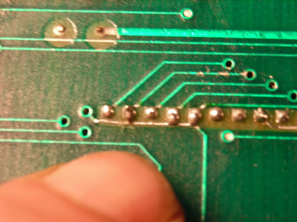

One other note:
http://i1224.photobucket.com/albums/ee365/kb0jjn/DSCN1053.jpg
This is why I say that I am only FAIR at soldering. This is shorting pins 11@1e to pins 14 16 and 17 of rom at 4f.
I will really check this board over.
OK, that's a good start, but you're missing some grounds. Here is a pinout (from Mike's Arcade of all places!):
http://www.mikesarcade.com/cgi-bin/spies.cgi?action=url&type=pinout&page=Galaga.html
You are missing ground connections on pins 'Z' and 22, and also on the 3 prong connector.
Also, I think that you need to fill out your 3 prong connector for the board to work properly. Certainly, put in the GND wire and +5V. Test after that to see if you get any sound.
Also, have you identified the volume pot on your board, and is it turned up so that if the board is producing sound, you'll hear it?
