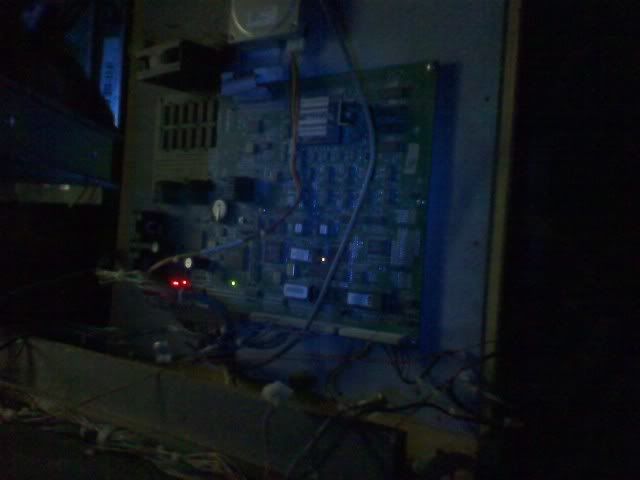

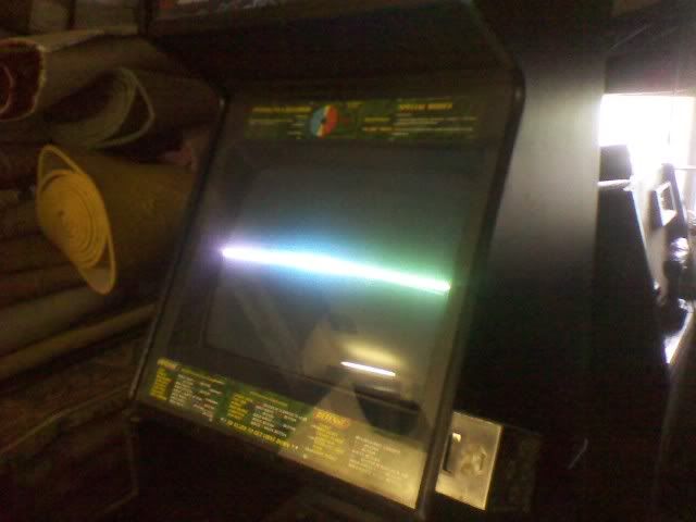

I have a Blitz 99 and can't get any video or sound to come out. The board powers on but no sound playing as to see if the game is going or not. I did have a wire unplugged and when I plugged it up, 1 bright line is going horizontally across. The board it self has 3 from what I can see, LED's lit up. It is a dedicated 4 player set up. When I tried to get it going, I did not have the stick panel plugged up or connected what so ever. Any Suggestions?

the bright horizontal line across the screen almost sounds like the remote adjustment board for your monitor is unplugged. basically, the remote board has some adjustment potentiometers on it that adjust the way the picture shows up on the screen. without it, it's just a horizontal line that comes off looking very bright because the entire video signal is squashed into it.
it's a small board probably in a plastic holder mounted to the inside wall of the cabinet that has 9 or so knobs on it. you can follow that cable that connects to it back to the monitor chassis board (the large board mounted in the metal tray underneath the CRT).
if this board is present and plugged in properly, then I guess we'll move on to the next item...

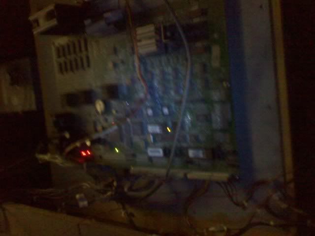

Well fella's. This was the best I can do for pictures right now. Sorry but you do get to see what I see and when I have a chance, I will be posting a video instead of pics. I think that would help out ALOT more. As for now, here are the only pics I was able to get. Any suggestions???

I've never seen anything like that before. it's funny, you can see red/blue/green separated, I thought green was supposed to be the middle one??
anyway. does your vertical size pot do anything? try going up and down with that. turn your brightness and contrast down... that looks painful for me to see here. lol
see if you can find a tag on the monitor chassis (the big board on the monitor) that says like WG 2550 or 2575 on it, determining what kind of monitor is a big help. these games shipped originally with Wells-Gardner U5000s and K7500s.
as asked previously, do you get any sound from the game? like the bootup "BONG!" sound?

For the Blitz, don't leave the game on very long with the horizontal line or you'll burn a dark line across the middle of the monitor. You have vertical deflection failure, but to help any more, we need to know what model the monitor is. If you can post a pic of the back of the monitor, we can probably identify it.

Assuming you're talking about the Blitz... my guess is that it's a U5000 with a bad vertical output IC, and needs the vertical sweep upgrade (includes the IC and a few other components): http://www.wellsgardner.com/products/details.asp?iCat=4&iSubCat=22 . Just a guess from experience and the limited information here.
