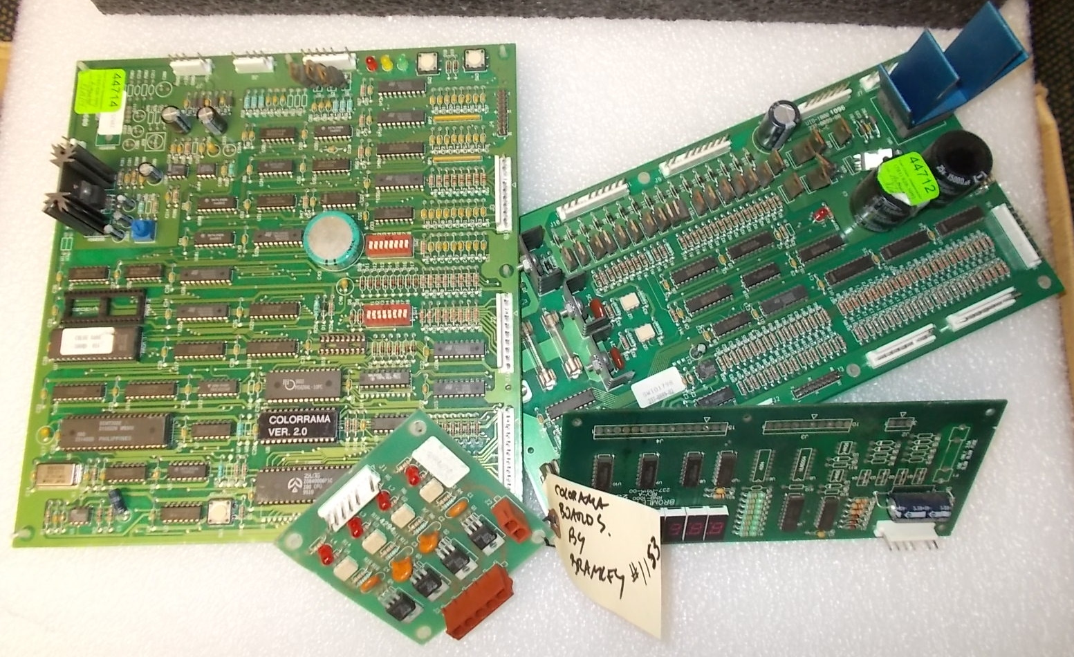

In the manual it's says to use the switches but I can find them anywhere :/ any help would be appreciated!

Thanks! That was great, would you happen to have the credit adjustment switch layout as well?

the Bromley manual has nothing about credit settings. I have copies of the Unis ones, but they're entirely different. I should've asked if yours was the older Bromley or newer Unis one.
I strongly encourage you keep the game at 1 coin per credit and use the 7-7-15-20-40 setting. I can take a picture of the board on the one at work, it's set exactly for all of that.
something else for you to test in the meantime though, there's the spinning drum assembly. the main board runs to a small board which then has wires connecting to the tabs for the wiper pins which touch against the sliprings. the head inside the wheel with the switches that the ball rolls into has a harness that connects to each of those sliprings. pull back on each of the wiper pins and verify you get a little click sound against the rings. this way you'll know that they're making contact. if you have an intermittent contact issues you can run into problems with the ball not registering against the switches. each of the wiper pins should have a spring. the L-brackets that the wiper pin assemblies are attached to are adjustable in and out from the rings. you want these to be set as loose as possible so as to not promote grinding the wiper pins. heavily worn pins will have a round chunk missing from them, after which they should be replaced. I think they're supposed to be about 1/4" thick on the fatter end that touches the rings -- if they're worn away badly, they'll need to be replaced.

another helpful tip, the 2 player and 4 player models of the game are identical. the 4 player one simply has 2 more players tacked on to the control circuit. in case you need any spare parts. the driver board is outfitted with a ton of 5 legged transistors (going off memory... that's been 5 years now) -- if any of those fail you can lose lights. and conveniently they're obsolete parts that you can't find anywhere.
