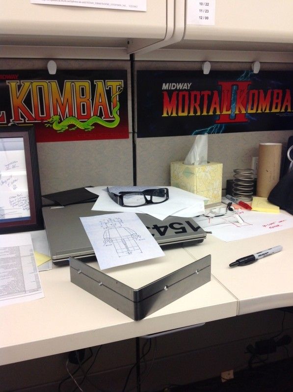

Just made this
Whoa,
I just made this 5 mins ago so I can fix my edges, & I come opon this topic just now, Crazy!
Guys, I just drill and beveled the mounting holes & slammed a 90 on it.
I use a teflon base tape so it wont stick to the bracket.
I'll be using this tomorrow morning. I can make more, But not in 316 stainless here.
Maybe make some thinner plastic ones....? this is my prototype. it lips over the edge about a Qtr.

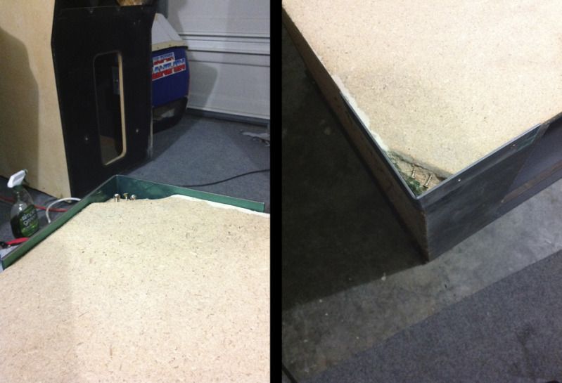

Attached you'll see what I am dealing with.
Then I added 3 more screws to the filling area to give the bondo strength. you know like rebar for concrete.
the next step was attaching the bracket. Which you'll see in the photos.
Ok, its 4am (PST), I am crashing out. I'll perform the plastic surgery tomorrow & take pictures & keep ya posted.
(Yes, this is a chunk Missing. I plan on filling it repairing it, when all said & done, I am gonna have to add those Cabinet corner Protectors. It'll be in the back no one will see.)

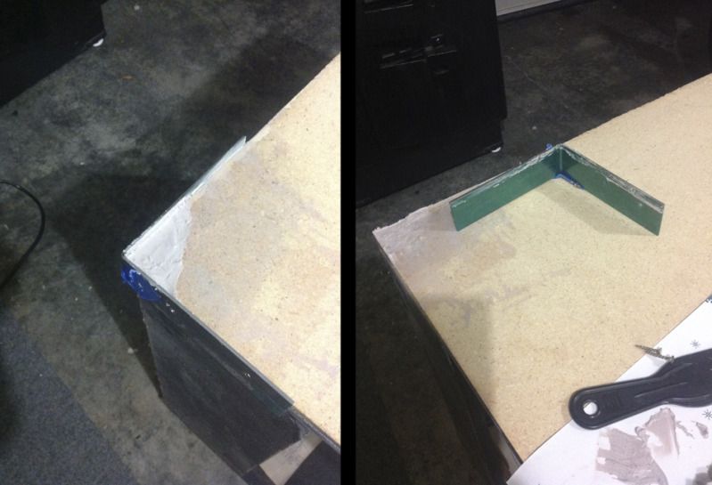

ok guys,
got the teflon tape on the bracket and mounted it to the cab.
I slammed on the Bondo and worked it in.
then I let it cure for 10 mins. After that I removed the bracket & let it cure over night.
Tomorrow i'll sand it down, & maybe apply another layer.

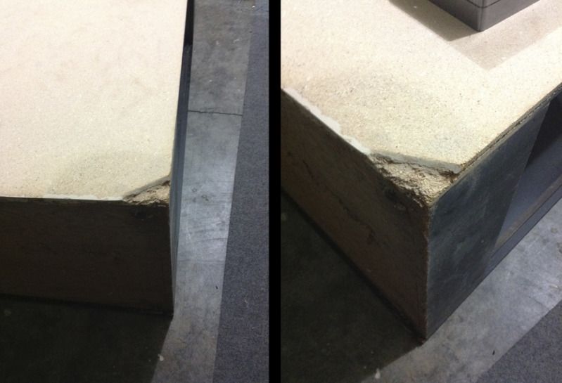

Dont ask me why there is T-molding grove on the back of this cab. I plan on filling it.
here are the Pic's
Now I got something to work with! not too bad....?
I hope this is helping a few of you guys out....?
