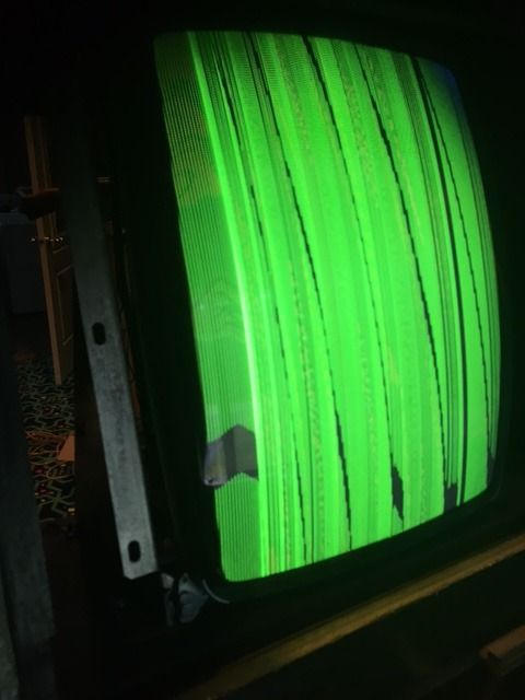

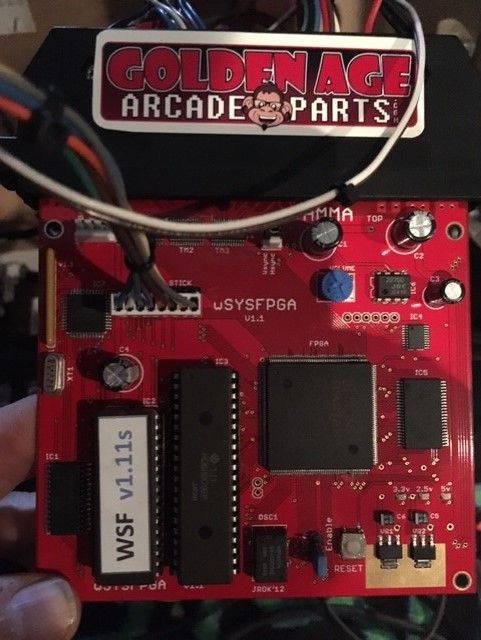

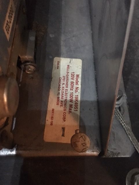

Wldfire made up a harness for this empty Sinistar cabinet that i had so i could run a JROK board in it that boots straight to Sinistar. I can hear the game boot up but can't get the monitor to sync up? Here are some pic's, thanks for any advice:

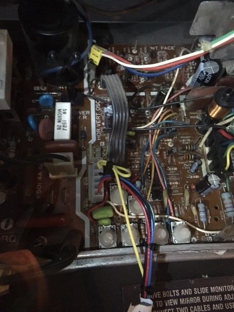

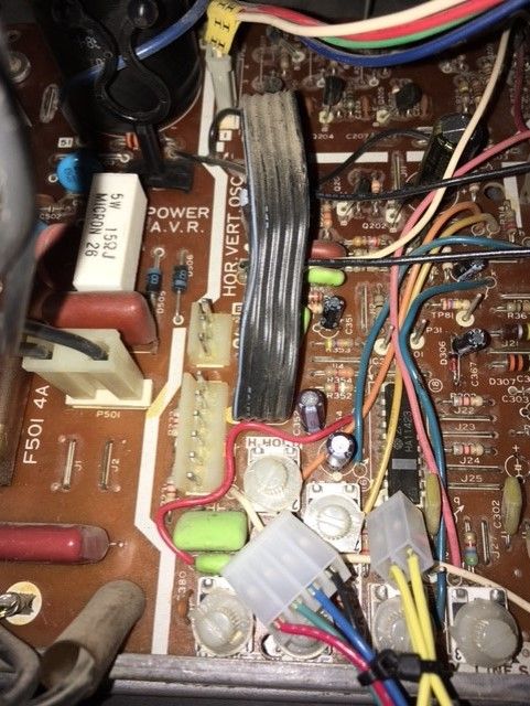

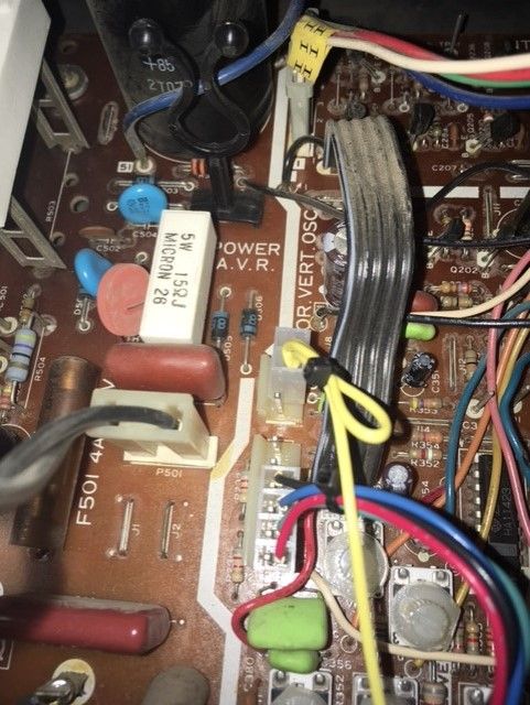

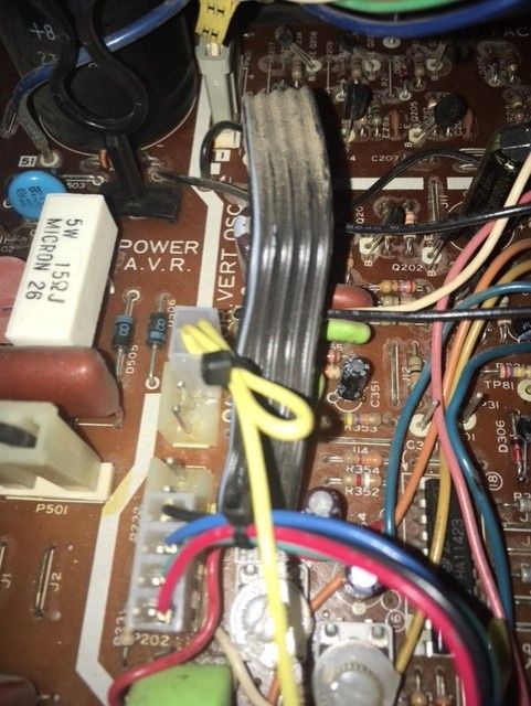

Move your 2 position sync connector, to the row of three pins(not six pins), putting your 2 position on the pins closest to the tube.
from the picture, it looks like you have the wire on the middle pin, which is the negative vertical sync. you need to go up one more, that's the negative horizontal sync where you feed composite sync to.
Thanks for the help, I moved it over one pin but still same issue.
Leave the sync connection where it is and try adjusting the horizontal hold. Follow this link http://antelopearcade.com/files/Monitor Manuals/Wells Gardner 19k4901 19k4906 19k4951 19k4956.pdf for the location of the horizontal hold pot. There is a picture of the location on page 3. Need to do the adjustment with the game and monitor on to get the right picture.
Sounds good, I will give that a try tonight. Thanks again for all your assistance, greatly appreciated.
