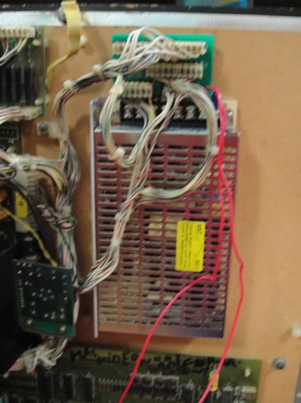

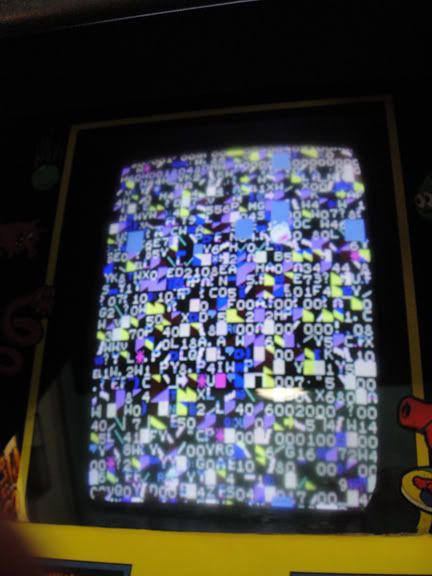

I attached the new Arcade Shop power supply to Q*Bert and had gorfchampion and alejandromad double check my work. They ok'd it and we turned it on. The game won't start and the screen is just gibberish.
Here:s a pic of the hooked up power supply:
And a pic of the frozen screen:
alejandromad checked the voltage and the power supply is working but we can't get the game to start. Does anyone know how to fix it our get the game to start?

What is the voltage with load?
Just make sure you measure it under load. Very important for Qbert. I had to set mine at 5.2 and has worked perfect since install last year.
does the garbage move around at all?
It is trying to do initial testing before going to "boot" mode.

The voltage was checked, under load,and adjusted between 4.99 and 5.12 or so. The game was power cycled a couple of times during these adjustments and no change was observed.
The screen is static - no moving around at all - it doesn't change.
Interestingly enough, the first time we turned it on the game looked like it started but the attract screen was frozen and it wouldn't take credits. A power cycle later it was just blocks of garbage video.
Well, this could be a coincidence, however, it looks like the processor isn't being recognized. Do you have another to swap?

Sorry for getting to this thread so late, but this is common-ish with Qberts I'm finding out. The reason you were getting gibberish on the screen is that the PCB in Qbert needs 5v and 12V (11.53vdc). When you only supply 5v to the board (i.e. use an arcadeshop power supply) the 5v will get to the board, but the arcadeshop power supply doesn't supply 12v to the board, it relies on the original circuit to do this. Coincidentally, the original qbert supply uses this 12v supply to create the 5v regulated supply to the motherboard, so when the 12v disappears it looks like your power board is shot (and it might be fine!).
When this 12vdc feed goes out, it's often a bad fuse or connection at the power block in the bottom of the cabinet. Worst case scenario, one of the bridge rectifiers might go. In your case, it sounds like a fuse (just like it was on my cabinet) and I'd recommend cleaning the fuse for good contact and install new fuses as well.
To elaborate a bit more...
There is an 11.5 VDC output (from a bridge rectifier on the transformer brick) that is supplied to the original MA-303 Power Supply Assembly and is used to create 5 VDC for game logic.
This is replaced (in the AS supply) by the switcher 5V output.
The game logic PCB also receives this 11.5VDC directly from the transformer brick (as shown in the attached image) - completely bypassing the MA-303 Power Supply Assembly (where the 5VDC for game logic is created).
An issue here would not be alleviated by replacing the original MA-303 with the AS option.
I am guessing, since I have worked on this game in person, that the connectors are tired and worn (they are, in fact, burned) and in disconnecting and reconnecting you somehow got them to make sufficient contact.
Sage, we should rebuild those connectors and follow Baz' advice regarding the fuse holders too.
