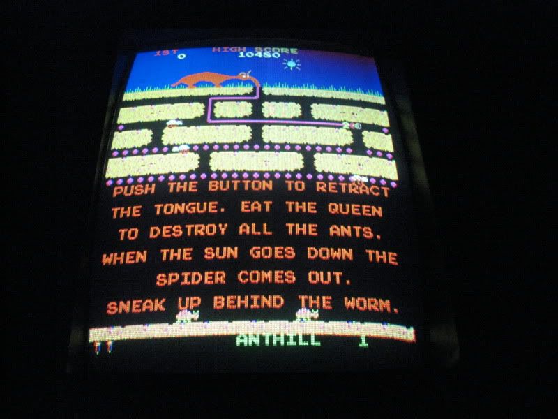

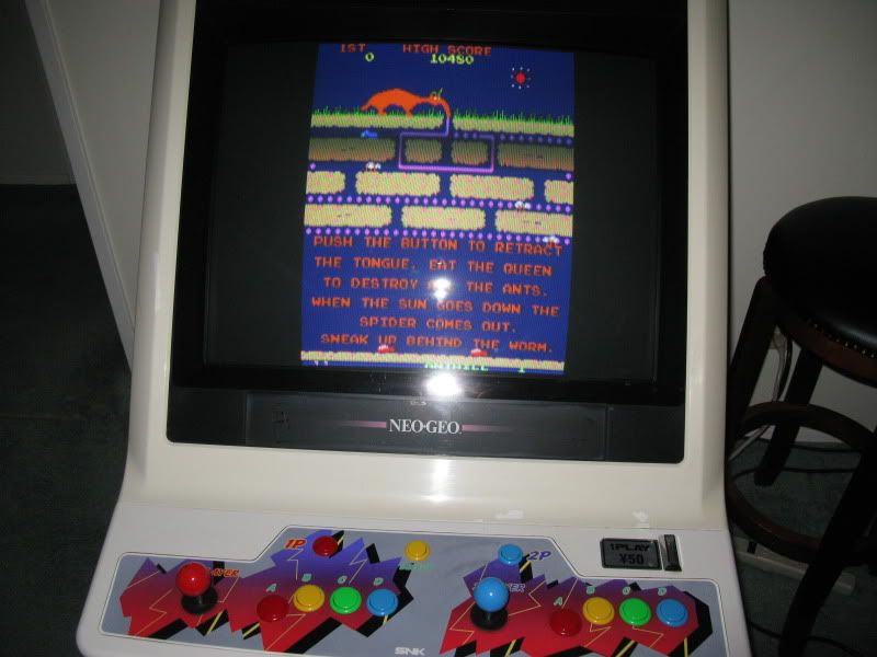

Yeah, the game runs on a hacked Super Cobra boardset with major wire hacking. I 'll try and get some pics for you tonight...
EDIT: here's the issue I'm talking about:
MAME with blue background:
PCB running with black background:

As crazykongfan mentions, that sounds more like an hardware interface quirk that cannot be emulated rather than something the CPU purposely does in the process of making the game work. I'm disinclined to think it's a real bug.
