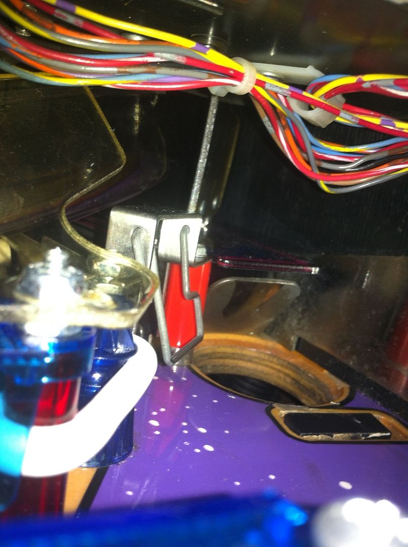

1: The machine tries to load balls into the hole behind the lanes under the Borg ship 90% of the time the ball will bounce off the wall behind the hole and go down the lanes.
Has this happened to you, how did you fix it?

IRRC there should be a metal form back there that directs the ball into the hole. Maybe yours is missing.
Yeah. If its not bouncing off the drop target take a poc and let us see. Thats kinda wierd.....
Found a picture of mine:

I would bet that if you can adjust the drop target so that it sits flish with the playfield your problem may vanish. Also replacing the plastic may help but it really shouldnt strike there. PITA to get back there but other option is to move the metal deflector towards the hole more.
Just watched the video...yeah, not the drop target causing it to launch. I know this sounds stupid, but have you tried getting a ball back there by hand, just to make sure the gap is big enough for the ball to fall through? I don't see how that could be the case, but figure it doesn't hurt to ask lol...

I can put the balls in by hand, and 50% of the time they go in. I thought maybe I should move the metal bracket back some.
Yeah I would check the metal thing to make sure it's not stopping the ball from falling in. Almost looks like the ball might be hitting it and bouncing back off so I would bend it up some and see what happens.
Sadly I cannot tell what's happening from the video as you cannot see much when the ball goes over the drop target.
However, it does look like the drop target isn't flush with the playfield and the wood behind the drop target is beat up. I'd guess (just a guess) this is causing the ball to jump into the air a little, hit the angled metal piece at the "wrong" angle, and bounce back.
If I'm right and the drop target isn't flush (it's hard to tell), I'd adjust it and see what happens.

I'd like to see a lower angle. Maybe the ball is catching some air as it hits the divot behind the drop target. That area on mine was well chewed, but I layed multiple layers of clear on it before playing it a lot, so I may have avoided having the same problem.
The other thing you can try is shimming the metal form up so that even if the ball is getting air, it still strikes it in a better spot to deflect into the hole.
