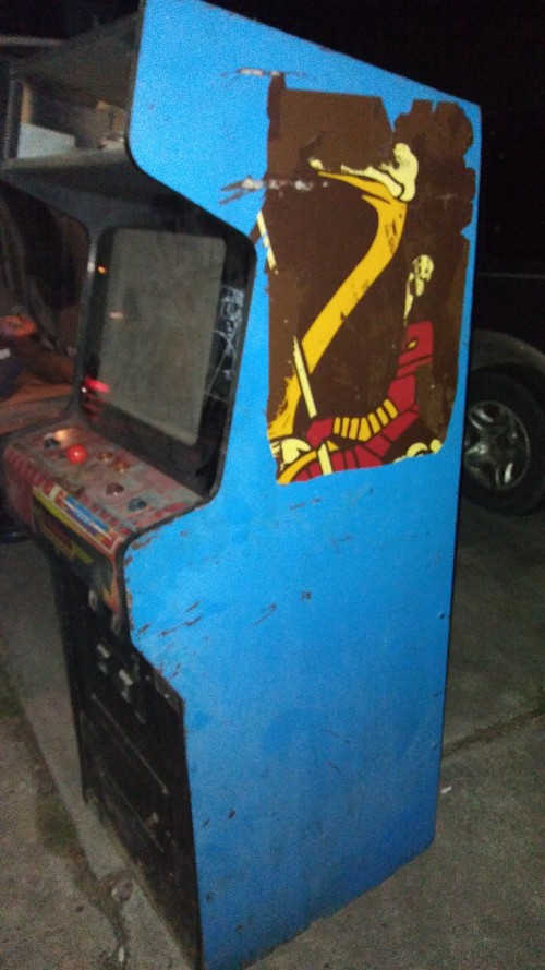

I have what I'm pretty sure is a Joust. What is the best way to get to the original side art? It's been painted over a couple of times by the looks of it.

First check to see if the side art is still intact under the paint.
I would try this method (magic erasers and isopropyl alcohol). Takes a lot of effort, but works on some paint.
https://www.youtube.com/watch?v=6-WJMEvav_Q

I'm in the same boat op. But my cab is gutted.
I plan on a multi approach tho.
Iso simple green and magic erasers. Where the art actually is, and in the brown places, I will try denatured alcohol to rewet the latex paint and try to use a plastic scraper.
Hope this helps. I'm already forgetting... But I think I paid 70-80 for mine. As I have been looking for 2 years, and the two I found were nonworking complete in the 400+ range.
Thanks for the advice. I used that method and it worked, but it is taking a lot of elbow grease and many pads. The art looks intact underneath, so that's good. Maybe I can attach the pads to a buffer somehow.

go slow and take your time or will destroy the art underneath.
no buffer please.
Set the game on its side so you can work like it is a table - it is a LOT easier on your arm that way (and the alcohol stays where you put it).
