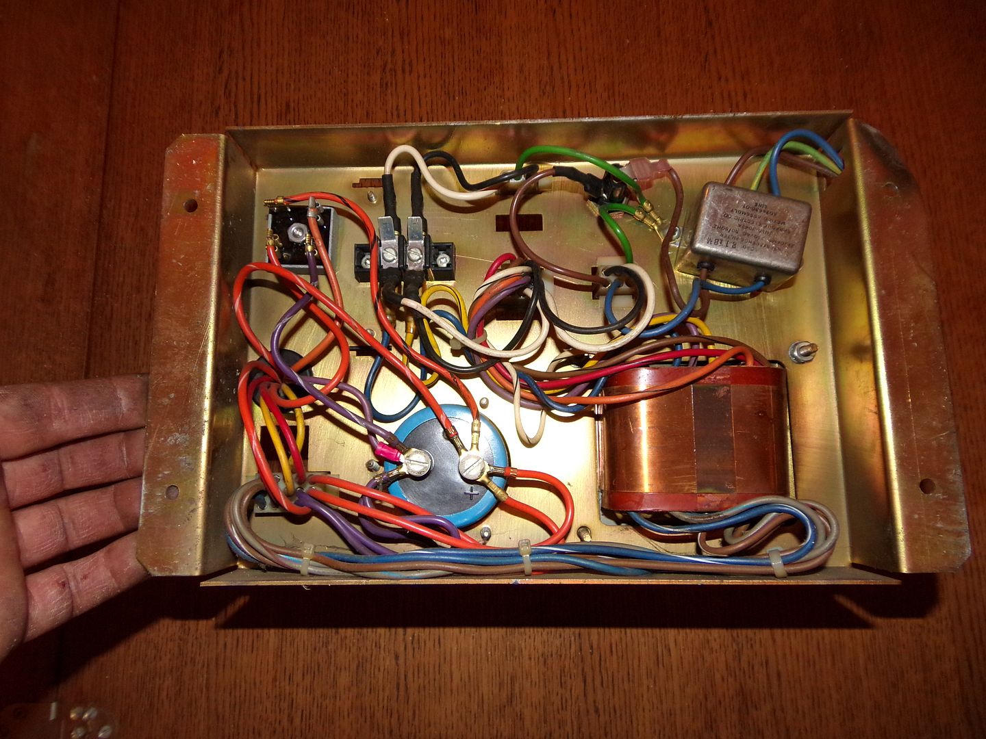

Find Waldo2 (rectifier) - under the brick. (Also in the NW corner)
Thanks VectorCollector - I'm either going insane or in the twilight zone. I don't remember seeing that part on the board, but now looking at the schematic (Q1 LM305), I clearly see it designated. I'll need to check that once I get home. Must be the soldering fumes...
Thanks - I had the brick out yesterday to replace the big blue. Here is a shot of mine that I took.

that looks like the cheap plastic case BR in your top left of the picture. if Ian doesn't have any parts i stock them all if you need anything.
Actually - many of the phenolic case bridge rectifiers with heat slugs are *better* than the full metal ones. They usually have similar junction-to-case thermal resistance (1.4 - 1.5 range). But the full metal ones always have much rougher tops (mounting surface) which results in a considerably higher case-to-sink thermal resistance. That's why Diodes Inc had always been my bridge rectifier of choice - glass smooth heat slug. Too bad Diodes Inc discontinued them. Managed to snag several cases of them when they went EOL, though.
Also, regardless of which BR you use, you want to use a good thermal grease when mounting it to the brick, to help transfer heat to the brick chassis, which will help keep the BR cool.
(Though in this case, I would measure the actual 10.3V before replacing it, as I don't suspect that's your problem. Usually when BR's fail, they short and blow fuses. Or they go open, but either way, they completely stop working. There usually is no in between.)
