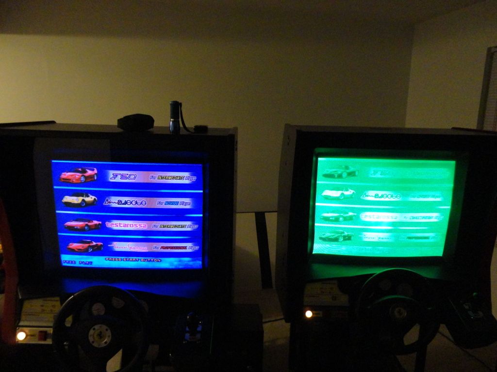

I picked up an Outrun 2 twin from DJ DNS and one of the monitors has WAY to much green. I played with the pot on the back of the neck board and all it does is change the tint. I also played with the "good" monitor (red adjustment) and I can never get the white all the way white, even with the red turned all the way down, the reds are still bright red and it will still have a little pink where it should be white. Do the Pots have a history of going bad on these monitors? Is that even the problem? Everytime I see a twin like this, at least one of the monitors look jacked up. I looked in the index for the monitor parts and I dont see pots listed, is that even the term? This is only my 2nd machine with color and I am a little lost.

If you can track down the manual for this, i believe it has instructions on how to adjust these. They are super touchy, took me forever to get mine to look right.
I got the manual and have tried the adjustments that why I am thinking it must one of the pots bad or something else. Any one else have any ideas?
tube?
A bad trimpot?
Why does it ohm out bad..
Did you swap it with another
trimpot? From neck board.
Dought its bad..
Video transistor test good?
Should test emission
On the tube..
Swap neck boards? Look the same?
Should be adjusting rgb tracking
On a black and white raster
Not a game play!!
See game monitor adjustment patterns.
