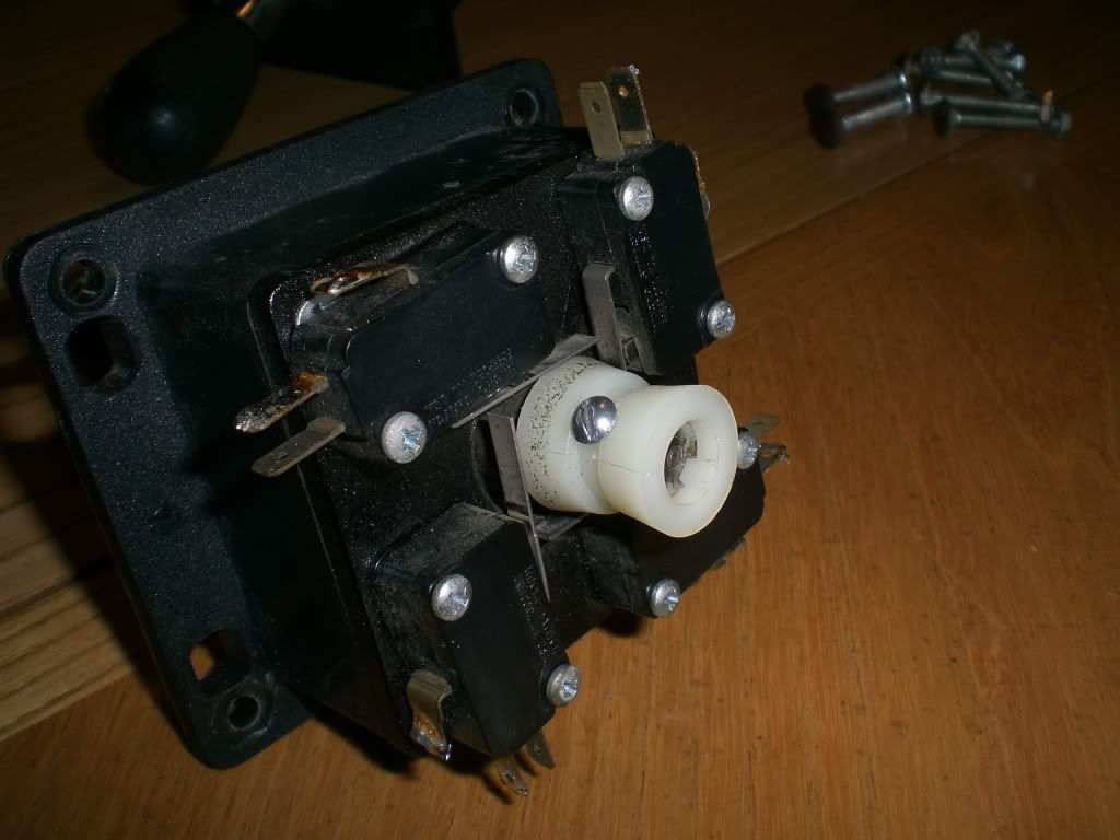

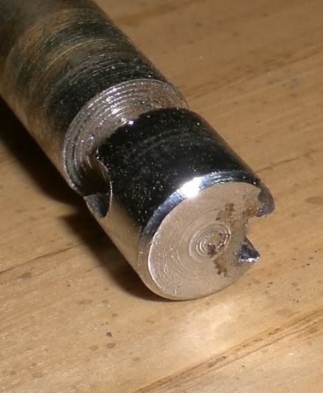

This stick doesn't work that way. There's no slot in the bottom of the joystick shaft for an e-clip. Plus, the final installation of the actuator doesn't allow for the joystick shaft to stick out of the bottom of the actuator, which I will show below.
After closer inspection, however, I did finally figure out how these sticks' actuators worked. Before I forced them off, I realize that there was a plastic 'nib' inside the actuator holding it on. These actuators were pushed on the bottom, then pushed against the spring tension for another 1/4 inch, rotated 180 degrees, then released 1/8" to lock them in place in the notch on the joystick shaft. You can see in this pic the slot on one side, and the machined notch on the opposite side of the shaft:
So here's my little actuator, with the plastic 'nib' sheared off on the inside. What do do?
Well, taking a cue from other machinists, I decided to fabricate my own 'set screw' of sorts. I started by taking the actuator to my drill press and drilling a hole in the side of the actuator in the same place where the nib was sheared off. Then I tapped in a machine screw (already cut to length) in its place:
Now I was able to slide the actuator on the shaft, rotate it, and lock it in place properly.
The finished product:
It works perfectly. Now I'll get everything inside cleaned up, sand the shafts on my drill press & re-paint them, and these sticks should be able to be re-used without any issues at all.
