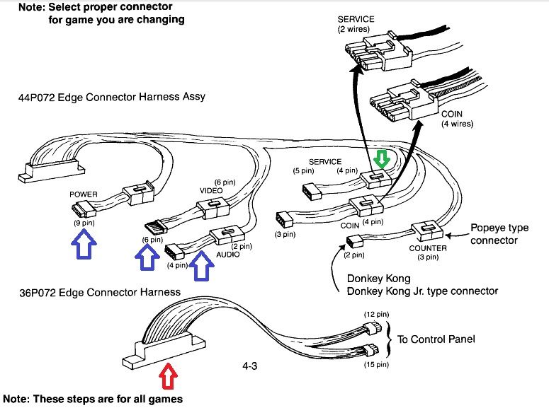

Found the manual for the Vs Unisystem kit for install in a Nintendo cabinet.
Here's what I see:
It appears that this harness is missing the items with blue arrows. That would be the adapters for video, 9-pin power, and audio.
The control harness (that is missing) is referenced by the red arrow.
Also interesting to note: on the service switch pigtail (noted by the green arrow), my harness has an 'extra' pigtail included, with orange wiring terminating in barrel connectors. Was this for some sort of remote mounted service switch, maybe? I'm not sure.
At any rate, I'd love to complete this harness, so if anyone has the remaining pieces, let me know. I'm fairly certain I can rebuild most of the pieces with the exception of the 9-pin power adapter. That I won't be rebuilding (at least the 9 pin connector side) since the connectors are no longer available. All of the TE Connectivity (formerly AMP Mate-n-Lok) connectors and pins are still available, though.
