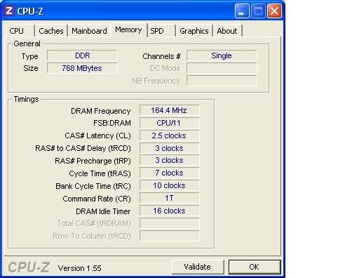

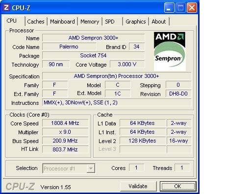

its an old asustek motherboard a8s-la(its a stinking oem compaq motherboard)wich im having a heck of a time finding sound drivers for (got all the chipset and vga drivers)asus does not support it because its a oem board
but ill just go out tommorow and snag a cheap sound card (since i cramed a 500 gb hd in it id like to at least jam to some tunes on it as well)and be done with it
im actually in my shop now typing this on it
shes kinda slow but for selling on ebay ,bsing on here ,and programing chips it should be plenty
