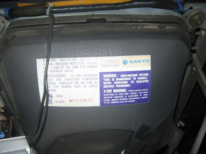

You need to adjust your horizontal width coil and/or adjust your horizontal frequency/horizontal position pot. Can you show us a pic of the back of the monitor or tell us what the chassis is.

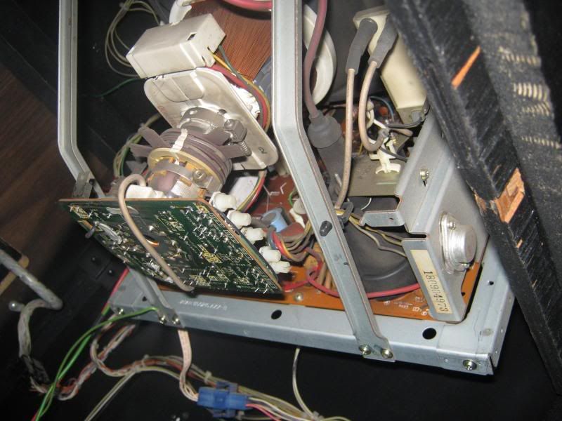

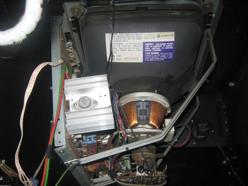

Well look at that cute little rare one. You should have some adjustment pots at the front of the monitor. You may have to remove your glass bezel to see them though. I can see them in your picture where all the white/red ribbon cables attaches to.
ill try taking it off and snapping a pic, so these would be hidden form the under side?
alright i took off the bezel and made some adjustments, i can fully see my ship now but the screen can still go up about a inch but the knob is all the way around

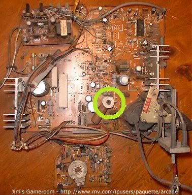

Keep in mind you are needing to adjust the Horizontal positioning.
Look for a VR452 near the large IC towards the front/left of the chassis. (when facing the machine)
Most likely will look something like this one..... been awhile since I've actually seen a 14" Sanyo.
