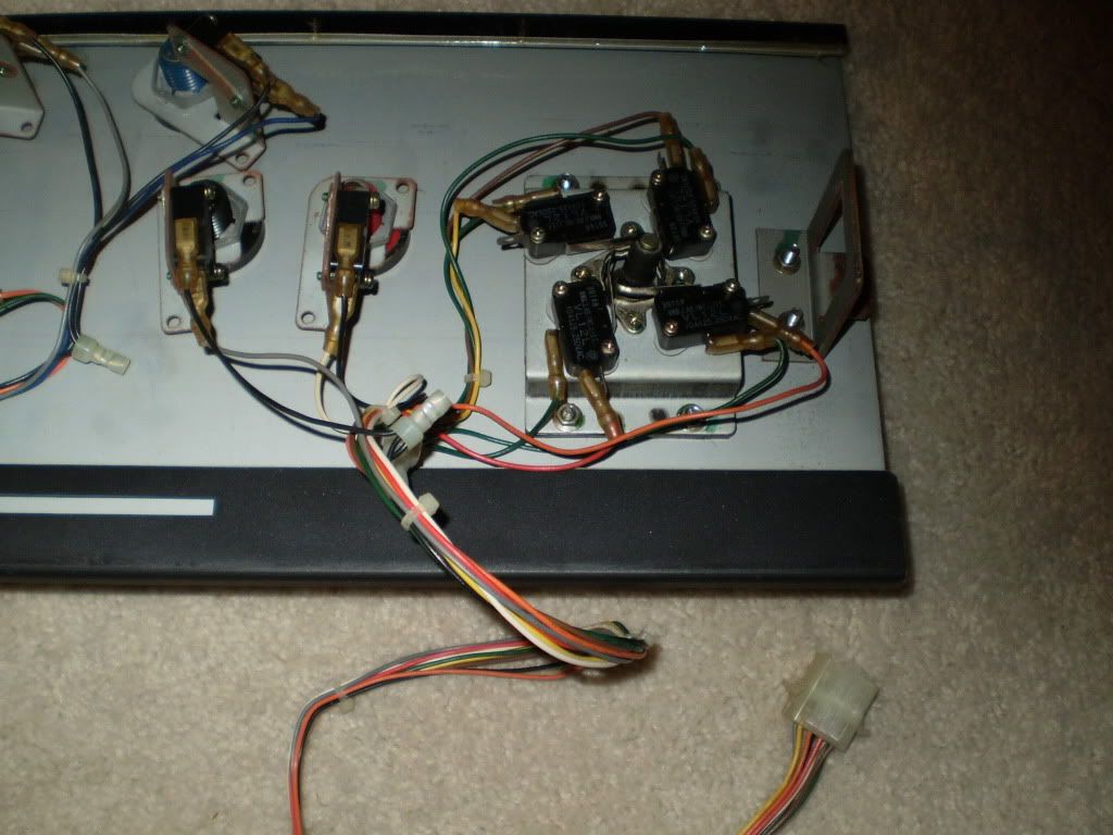

Ok, the Nintendo Vs. Super Mario Bros. game I bought about a week ago... It's the most-finished project I ever purchased so far... Screen is a little fuzzy and discolored, but highly playable. It boots. Sound works. Life is mostly good.
The wiring on the control panel is wack, however. The only buttons that work at the moment are: 1up start, 2up start, and Player 1 Jump. And the P1 jump used to be the Player 2 secondary button, so I just moved the leads. And also, if I move the joystick, nothing. In any direction. But. If I jump, I can jump left or right. And when I've picked up a mushroom, and Mario gets 2x big, when he jumps, he is jumping while squatting. I don't know if this helps figure out what's wack or not...
This is my first Vs. system BTW.
There are two cable bundles / plugs coming to the CP. Is it safe to assume that one is for P1, and the other P2? Or no? One set has a Black cable for the common ground, and the other cable set uses a funky off-green/dark teal for ground.

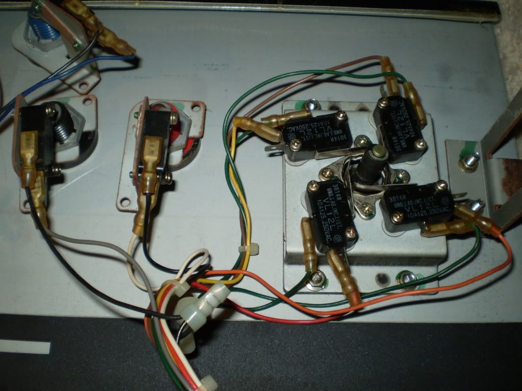

I originally thought I'd just wander outside and just play around, switching wires, but now after attempting to do that, I see that that is a strategic nightmare... I would love to be able to start with someone aiming me in the right direction with: This color wire goes here, (Obviously all switches have a common ground) this color goes here... Etc.

Here are a few pics -
Sir, THANK YOU SOOOO MUCH!!!! :D
Well, shoot. I wired it like yours, and P2 plays perfectly, but P1 is still doing the same crap... No joystick movement unless jump is pressed. And when he's 'mushroomed' he is always squatting, unless L or R is pressed.
I wonder if maybe the P1 "down" switch is somehow constantly on? Hmmm.

I would take the ground from P2 and try it.
Could be multiple issues.
Verify your wiring from the pics.
Ensure that you are checking the orientation from where the pics where taken.
Pull the P1 joy out and use an alternative for troubleshooting.
My money is on the ground to P1 joy though...

Ok, thanks a bunch for the specific directions, Krajkerjac and Brien. (Gotta love local help!) I finally got around to looking at it tonight...
Unplugged, everything seemed to be wired correctly. I noticed that the joystick switches were not on the same ground circuit as the button switches. However, when plugged in, all shared grounds. (Based on continuity)
So I guess my next step is to take a look at the edge connectors... And FCC thing. The grounds for P1 joy seemed to work - all four joy switches shared a common ground.
