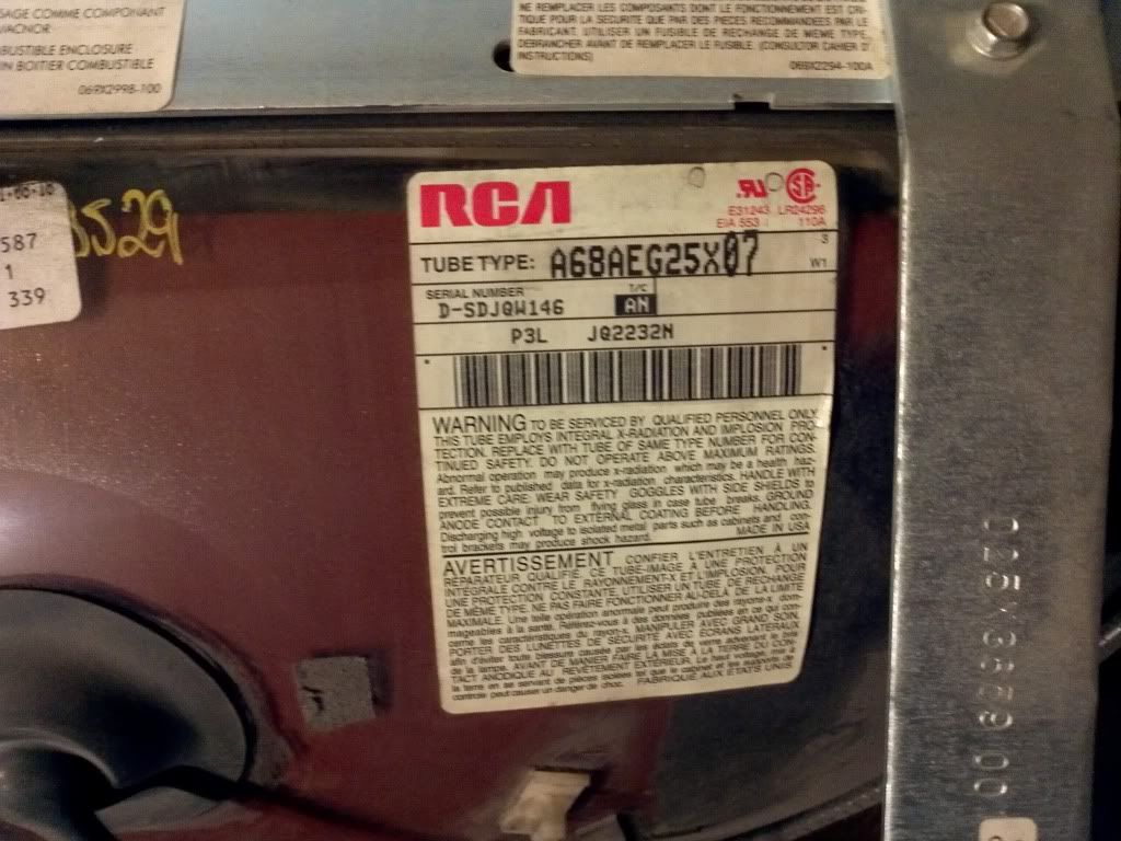

Hey guys, i just got this monitor, i haven't tested it yet but i know its not working. id like to identify it so i know what cap kit i need to buy. (i suspect its a D9202 but i cant find a cap kit for that on Bob Roberts' website)
Thanks in advance.
Wells D9200 series.

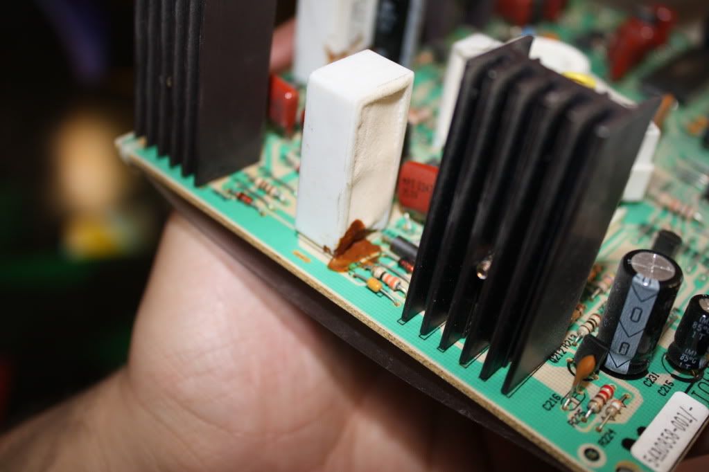

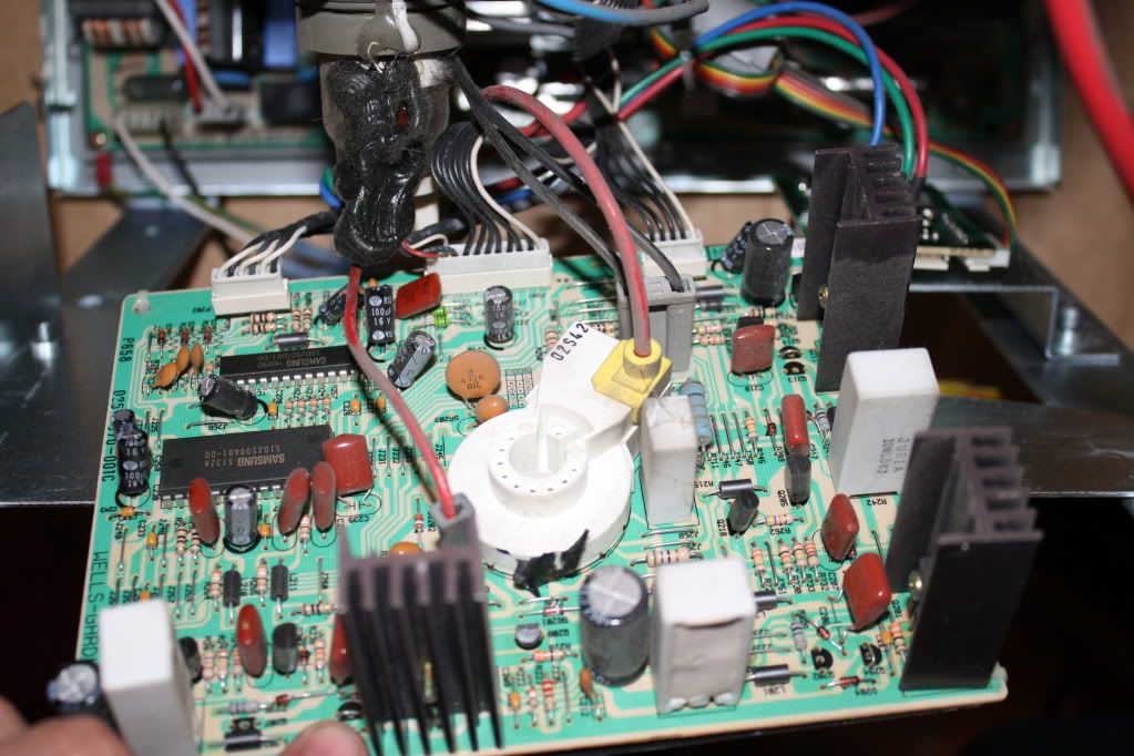

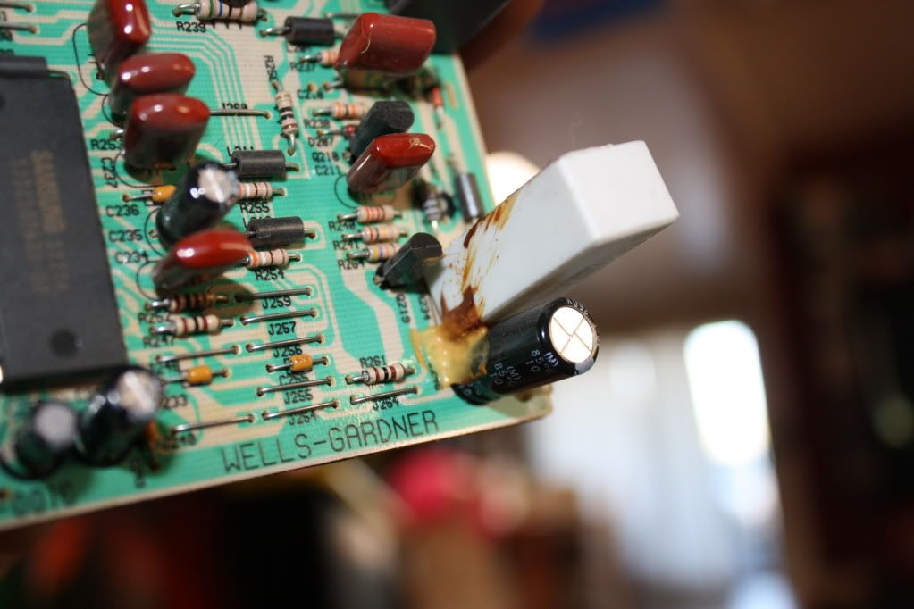

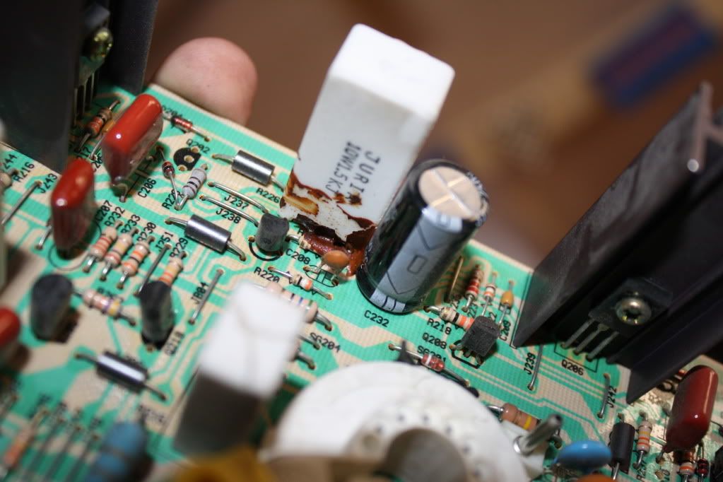

Took off the neck board to inspect it, saw something that kind of made me raise an eyebrow... i know sometimes they use a paste or adhesive but it looks like a cap burst or something... i have attached some pictures... what do you guys think? the caps dont look swolen or burst but they could have opened from the bottom...
What are those big ceramic blocks? are they resistors?
Thanks again.
The blocks are resistors and the yellow-brownish paste is just glue. It is used sometimes to hold caps in place. I never reapply it when I replace those caps; I don't think it is necessary.

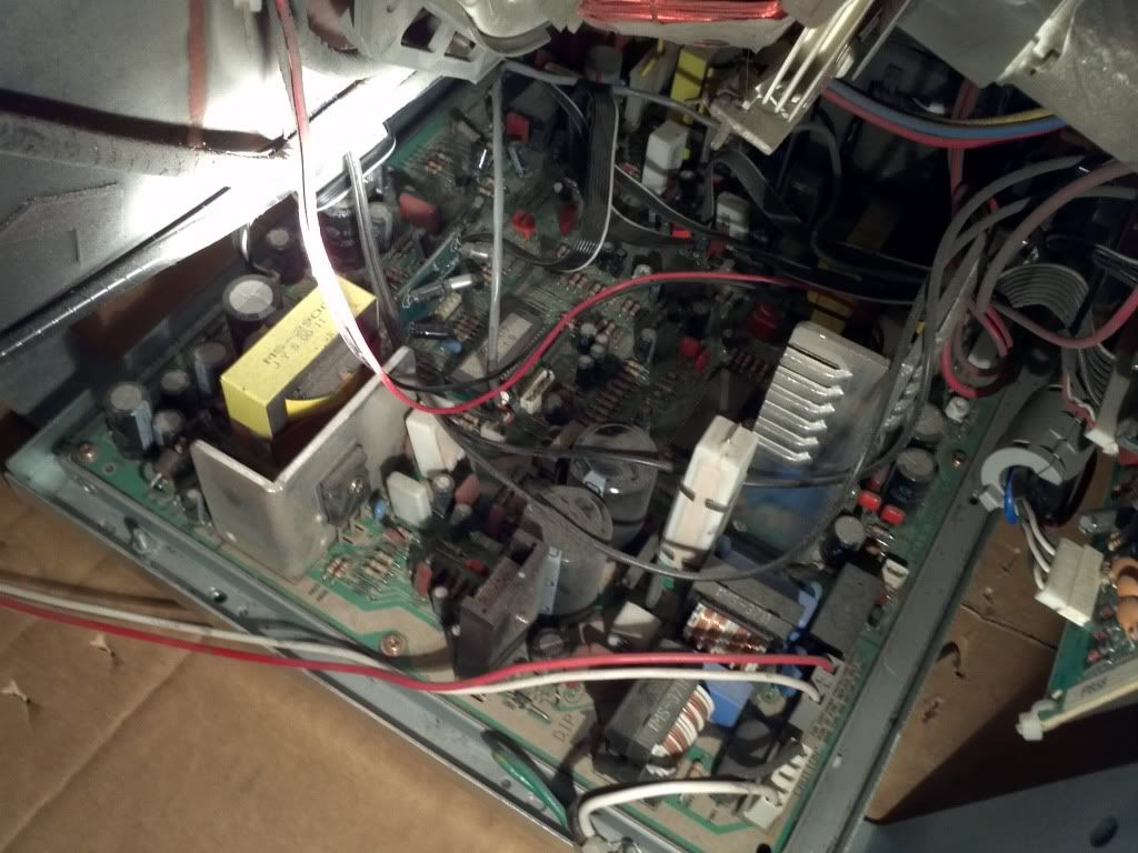

I touched up a couple of cold solder joints that i found on the neck board and on the little board that has the inputs (vga cga ect) and plugged it back in. I got the monitor working again without green. I decided to play gauntlet out of boredom and about an hour into game play i got green and played the game another two hours or so, with green working the whole time!
Shortly after i stopped playing green went away again. its now just displaying blue and red! : ( what could be the issue here?
