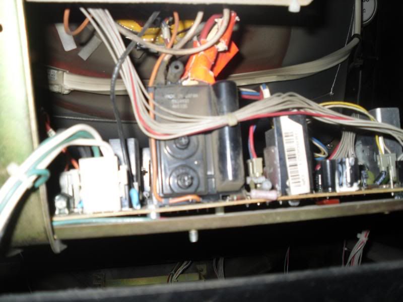

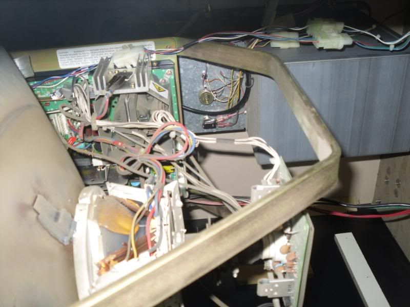

Im going to order cap kits for all my 25's I know one is a u2000 but these others Im not sure.
First is virtua cops monitor
Second is T2s monitor
and last but not least dynamite cop hard to see becuase the monitor is encased in plastic shell
Im not good at taking pictures so If I need to provide more please dont hestitate to tell me to.

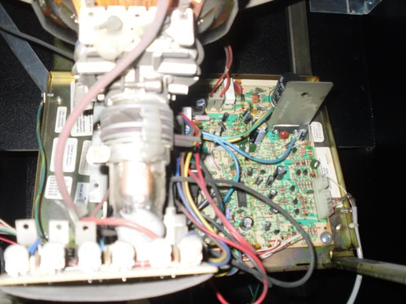

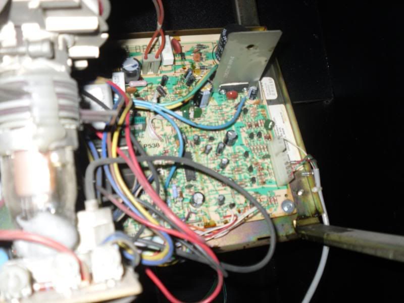

The two middle shots are a Wells-Gardner K7000 series. The last one looks like a late era Wells-Gardner, but honestly....that picture leaves a little to be desired. I can't really see any detail. Best pictures are taken when the chassis is removed from the tube.

Ill decase it tommorow not much room to take pictures its in a durmold cabinent. At this point I need a cap kit for a u2000 and k7000
On the last monitor, there should be a sticker on the back left corner near the video input pins. On that sticker will be a number that will start with (if a 25") WGM25xx- , with the xx being the identifier for the chassis type:
20 = U2000
50 = U5000
74 = K7400
75 = K7500
etc...
Also, on that middle K7000 chassis, it looks like there is a sticker right next to the video input pins (on the metal frame). That sticker should have the model number on it (like 25K7197 or something).
And on that 1st chassis, if you have a connector in the middle of the chassis that connects to either a LOW or HIGH connector, then it most likely IS an MS8-26SU. If it doesn't have that connector, it might be a different model...
I don't think you're reading the right label. The one you listed sounds like a serial number.
Post a pic of the label...
Alright finally got the monitor out of die hard and its a u2000 or wg25k2193 same as the other I have, to bad I only bought one cap kit lol. I noticed when taking the cab apart that the bottom of the remote board is smashed on the connector might this be part of the picture problem should I replace it or just get a new cable? I was also wondering when I discharge the monitors can I do it right from the table they are sitting on and do I have to ground the chassis b4 discharge?
