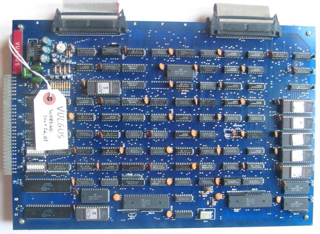

So I have two Gottlieb boards that look just alike but have different numbers. One says C-22248-1 and the other says C-22248-3.
And Then I have a SNK 2-board set with one board labeled 84602-02A and the other is 84602-01A-4 and looks like it might be JAMMA??
Here's pics:
On the Gottlieb boards, what are the numbers on the ROMs (the GV1xx)? That will tell you what game it is. For example, GV103 is Q*bert, GV100 is Reactor, GV102 is Mad Planets, etc.. I'm guessing yours is GV109, which is Mach 3.
Both say GV103....so two Q-bert boards, apparently. Interesting. Thanks for the info!
