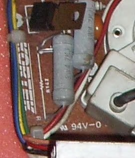

I think it's a really old Kortek (I have no idea which), possibly an attempted copy of the G07-CAO?
Why do I think that? Well, here's a pic of the corner of your neckboard:
And here is a pic of a corner of the neckboard on the newer Kortek KTM-20:

Nice call, you may be right. If it is a Kortek, Ken Layton would know for sure what it is.
Look at the logo on the neckboard in photo 2988. That's the Mitsubishi logo on there. Now look at the markings on the tube label in photo 2985. See the Mitsubishi logo there too?
The circuit boards were made by Mitsubishi and the tube was also made by Mitsubishi would tend to indicate this monitor was made by Mitsubishi.
This mounting style looks like it's in a Frogger cabinet or it was made during the Frogger era.
This is definitely NOT a Kortek monitor.
I was gonna say the same thing.
So, we are looking at a Sega branded Mitsubishi manufactured monitor from the early 80's. Possibly pre-nanao as the other nanao's I've seen have nanao silkscreened on them. Sounds good to me. Thanks for all the help ID-ing this.
