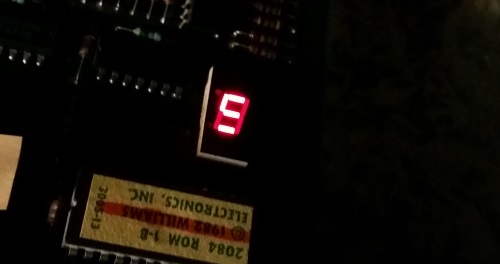

I recently acquired several new machines, but most of them are not fully functional. This Robotron seems pretty promising though.
This is what it's doing right now. It does not coin up.

It was giving me a 1-1-4 error, so I replaced that RAM chip with a new hacked 4164 (I'm planning to do a full RAM swap once I get the parts to make an adapter for 4164s.) Anyway, once I replaced that RAM chip, it hasn't displayed the error but it keeps displaying a weird symbol like this http://chupnet.com/images/robotron.jpg . Any idea what that could indicate?
Also, the three LEDs on the power supply board are all lit.
I checked the voltages at the RAM and I was only getting 11.8v for 12v and 4.6v for 5v. Maybe I need to put new caps on the power supply?
Any ideas are appreciated. Thanks!

also, you can't mix a single 4164 in without modifying the power running to it. the 4116s have +12 running to the pin that would be for 4164 +5. simply dropping a 4164 into a board that's set for 4116s will fry the chip.
Right, I followed the instructions to leave pins 1 and 8 out of the socket and jump pin 9 to pin 8, giving it +5v.
double check your work at that RAM (not that theres much to screw up there). 4.6 is a bit low but that board would probably boot just fine at that level.
Do you still have the original 4116? If you do, put it back and see if that error comes up. Move it and see if the error moves with the RAM. You could have a bad socket.
However, I'd still rebuild the supply and its connectors, replace the three caps just below the power input on the MPU and replace the ROM to MPU ribbon cable.

Before it gave me the 1-1-4 error, it was also showing that weird symbol. I'm wondering if there's a cap so far gone somewhere that it needed to warm up before it was able to detect the problem or something.
I'd suspect the power supply and that ribbon cable between the ROM and MPU boards if they have never been changed.
I second rom ribbon cable. there's a reset button on the MPU near the power plug, you can try bending the rom ribbon around and hold it in place and press the reset button. if you're ever able to get the game to boot then you'll know it's the ribbon.
1-1-4 error is not a general error, it should be limited to just that socket. the ram rows go 1-3 left to right, assuming the ram banks are in the upper left corner, and 1-8 going bottom to top. you can pop the plastic housing off the pins and take a look to see if any pins got stuffed or if there's some kind of corrosion in there.
The +5vdc is a bit low. If you have another 6809E CPU, give that a try. The strange code on the ROM board could be a sign of a bad 6821 on the ROM board which will also cause the game to reboot after the rug test.
Rebuild the power supply, replace all of the power headers on all boards and the pins in the harnesses.

I checked continuity on the ribbon cable pin by pin and it seemed fine. I've been cleaning the socketed chips and their sockets as well as all the pin connectors but so far no change.
I don't really have any spare parts at all so I'm just going to have to go the route of replacing things until it works. The top left connector on the power supply board had a couple of badly oxidized pins, so I assume that's a sign that it's gotten too hot and I should replace the connectors.
When cleaning I did notice that quite a few chips have extreme oxidation on the legs, so I have been scrubbing them with Deoxit and a toothbrush to try to loosen some of it. Is that expected on chips that don't have tinned legs?

So far, I have replaced all pin headers and connectors on the power board, recapped the power board and sound board for good measure, replaced a blown fuse on the audio board, and cleaned all other pin connectors and socketed chips. The -5v and 12v are now very close to their intended value, but +5v is still only at 4.8v or so. I'll get new caps for the MPU board and see if that fixes the voltage.
Anyway, the problem is still happening. Is there a good way to test the CPU or the 6821, or do I just need to install new ones to see if it helps?
