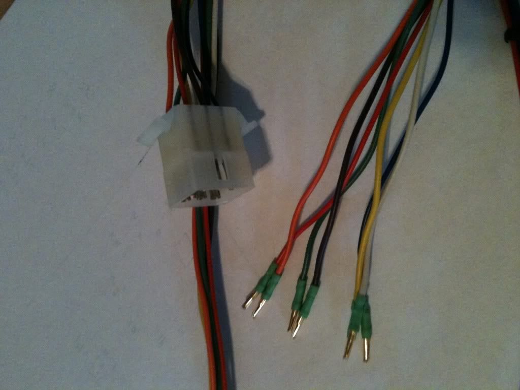

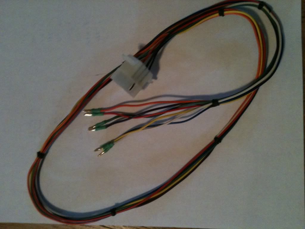

For years on my Heathkit I've just used a homemade pigtail adapter -
It is just a molex connector on one end, and small female molex pins (covered with shrink-tube) on the end of each wire.
Be glad to figure out and send the pinout for you if you need it - just send a PM to remind me.

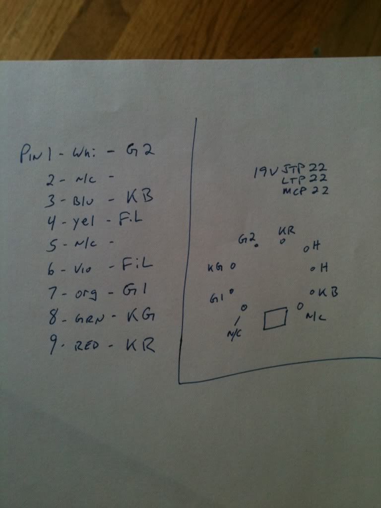

Heathkit pinouts as requested
Here are the pinouts for the Heathkit - as mentioned, these were kit built, so verify yours first - I have had two of the units, and those two were the same at least.
Here are pics of my adapter - I should get around to building one with actual CRT connectors, but this works when I need it, then I put it away and forget about it...
http://i1101.photobucket.com/albums/g436/444mike444/photo2.jpg
http://i1101.photobucket.com/albums/g436/444mike444/photo3.jpg
http://i1101.photobucket.com/albums/g436/444mike444/photo.jpg
The pinouts are:
Pin1 - G2
Pin2 - n/c
Pin3 - Kb
Pin4 - Fil
Pin5 - n/c
Pin6 - Fil
Pin7 - G1
Pin8 - Kg
Pin9 - Kr
Hope this helps,
