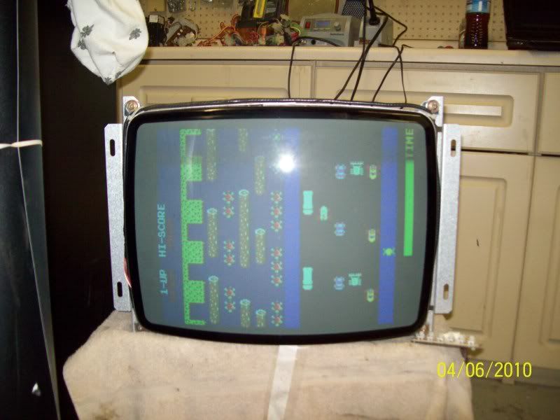

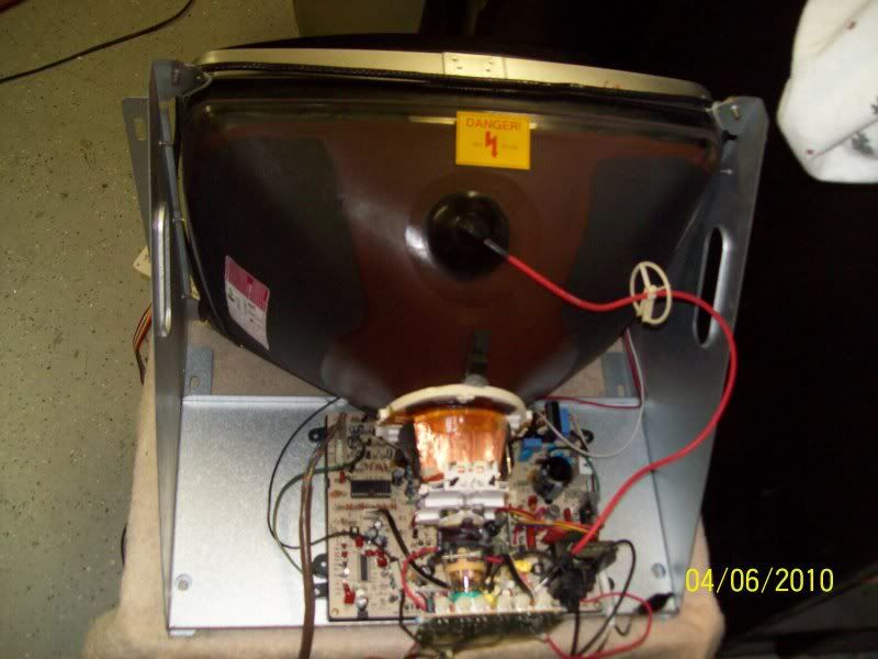

A few days ago i was given what looks like a brand new Happ monitor Model # KJ-1915 from the year 2000. The guy i got it from said the original chassis was dead within a couple hours but he never sent it back. After looking at this thing for a while, the chassis sure looks alot like a Wells 7302 chassis and it has alot of the same components. I happen to have two brand new 7300's so i did some metering of the yokes and they were a dead on match so no yoke swapping was needed. I simply threw a chassis on the frame and she's a beauty. The tube on the Happ monitor is an A48QAD220X which should be coupled with a yoke that has a simple sticker on it that reads SW-2001. No yoke swap, no converging and no image size/pincushion issues, this thing is pretty much plug and play after i finished putting it together.
