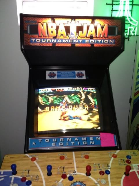

Just to update. I finally replaced my faded instruction sticker with a new one from a set of worn NOS ones and added my 6th game into my switcher...Superman!
I'm not going to say its my first choice, but the price was right and being a 2 player game, it didn't need kick harnesses! If a TMNT 2 ever shows up, or maybe an X-men, it will probably be quickly replaced.

Hey from a newbs perspective, what parts would I need to get to add The Simpsons in my NBA Jam cabinet so I can play both games on it?
If you want to do a simple swap of the boards in the existing Jamma harness, then i believe all you would need is the Simpsons board and plug it in. All the weird wiring and stuff I did was to have all the boards in 1 cabinet that allows me to switch between them with a remote control.
Gotcha. I don't think I have the knowledge to install a 6 in 1 like yours but what you have is so damn cool. I'd probably just add Simpsons and Turtles to my nba jam cabinet if I could do it.
It can be done with a little bit of guts. Fortunately, both of those are Konami games, so you can buy kick harnesses for them, albeit,you have to add diodes to them to prevent feedback (although I still get issues occasionally). Someone is trying to work on a solution to avoid the kick harnesses altogether, but I'm so far into doing it this way, that it would be a waste of money for me.

Another board added to the setup, after 2 months of troubleshooting and repair...X-men.
I had a ram error that had to be repaired and I recapped the custom sound chip, so I should be good for awhile. I also had to do yet another set of kick harnesses...diodes and all. This set came from Bob Roberts. It was okay, but I would've likes another foot of wire. Additionally, the sets I got didn't have a wire for the 3rd action button...even though he has it labeled as a white wire on his paperwork. I ended up repositioning the coin door ground wire and using that, because I have nothing wired to the coin door. A minor hiccup, but annoying nonetheless.
