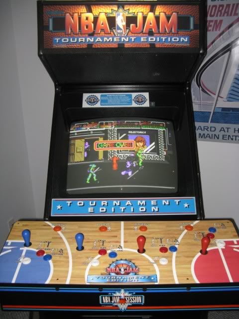

NBA Jam seems to be one of those red headed step-children of the collecting community. Maybe it's too commercial? Too mainstream? I don't know..maybe it's just because it's a 90s game. In any case, it's a game I played my entire freshman year in college after lunch in our cafeteria, and then in the years after on my friend's SNES. So for me, it's another nostalgia game. It's also a 4 player game (which I have none of) and is an easy game to play for non-gamers who visit my house. It wasn't something I'd originally planned on getting, but was fortunate to find one an hour from my house via eBay. Even better, it was the Tournament Edition and happened to be Version 2.0, so it has the hidden Mortal Kombat characters!
So here I was at the pickup. I've managed to fit several cabs in my wife's SUV, but unfortunately, even with the control panel removed this baby wouldn't fit.
However, after keeping it under 55 mph, it made it home safely. Here's what I started with when I got home:

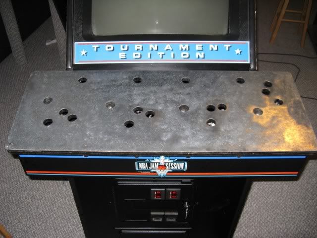

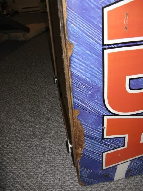

Everything was fully working, which was a bonus. However, the artwork was severely faded and the bottom had some swelling and chipping.

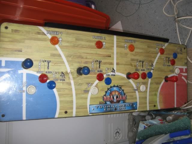

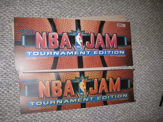

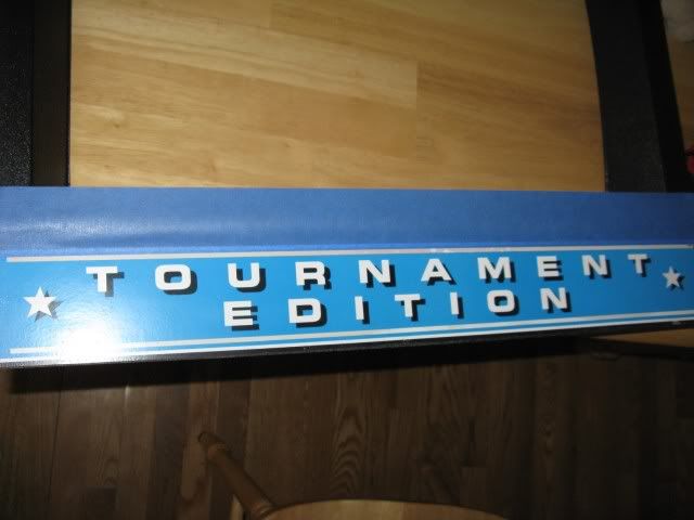

There were scratches in the artwork and stains on the control panel. The real bummer about this game, at least for me, is that there's no repro artwork out there. Gameongrafix.com used to have some, but they pulled it due to concerns with NBA licensing. Classicarcadegrafix.com only has one sheet of conversion decals for $99…and that's too rich, even for me, for 2 small stickers for my monitor bezel. I managed to find a NOS marquee from Quarter Arcade (on the top, the yellowed one is on the bottom):
I also scored a NOS CPO from Mylstar:
For those of you who may need it, I paid to have it scanned at 600 dpi. I've contacted someone about having it reproed for those interested, but until then, here's a link to the file (it's huge at 543MB):

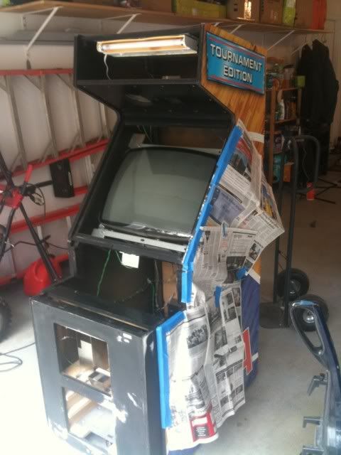

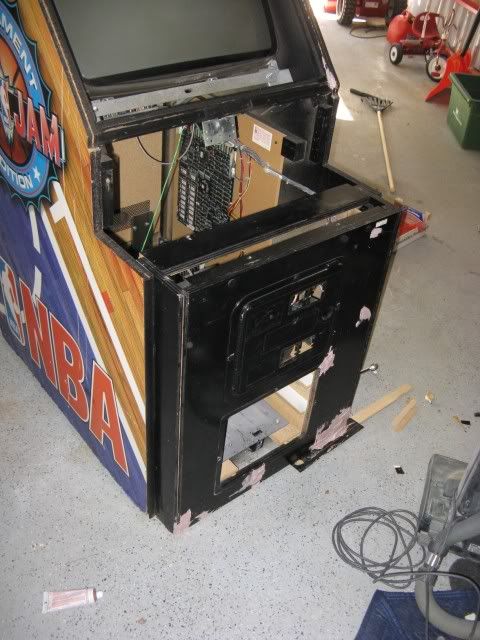

So I started about this in typical fashion. I stripped everything down, sanded, wire-brushed, and steel wooled all of the metal parts. It would be nice get metal parts powder coated, but I don't have the time, nor do I feel like wasting money doing it. I primed and sprayed them all down with satin black. It holds up well enough for my minimal-use basement arcade. I also started the awful process of Bondoing and sanding:
The front was originally a gloss black, so I masked off the side art and sprayed the front:

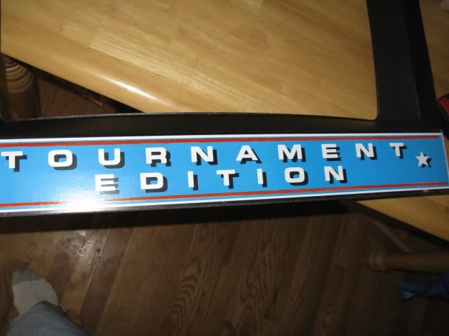

From there, I jumped to the monitor bezel, which was severely faded:
A little masking and a Sharpie helped a lot:

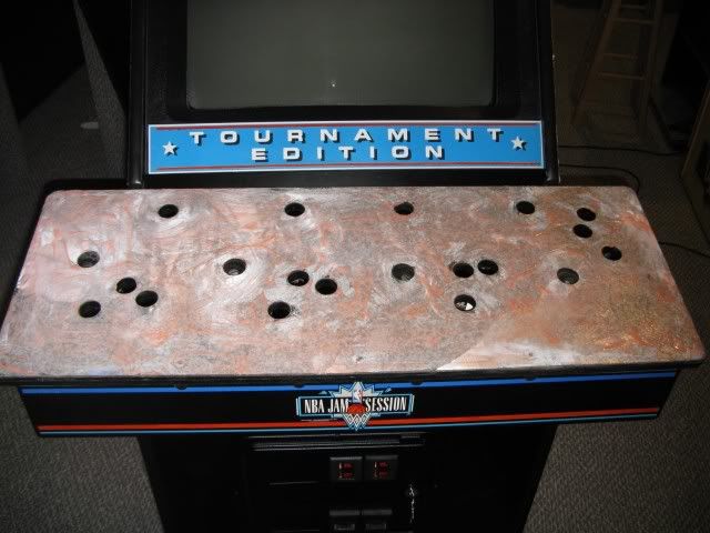

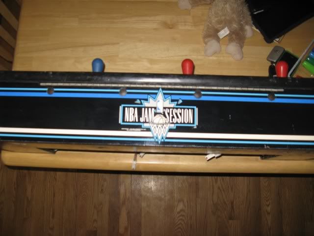

The body of the control panel was also severely faded.
I used a Sharpie as well to fix the faded Midway and front, and the results can be seen in the final photos.
I stripped off the CPO using a heat gun, then let some Citrustrip go to work:
Unfortunately, that didn't do the trick. I used Goo Gone, Goof Off, Brush Cleaner, WD-40…everything I had…and finally got it off and wire-brushed up:

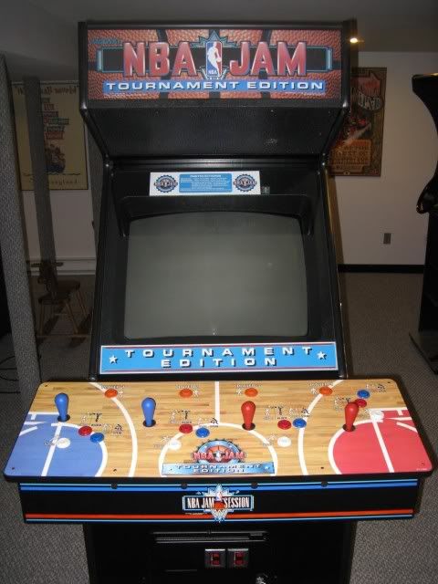

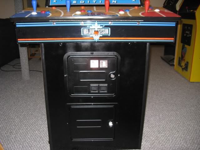

I installed the new CPO, replaced all of the joysticks and all of the buttons. All of the T-molding got replaced as well, and got rid of the Peter Chou power supply.

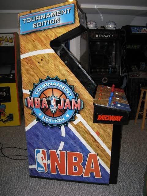

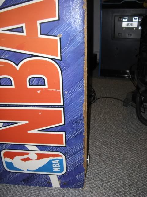

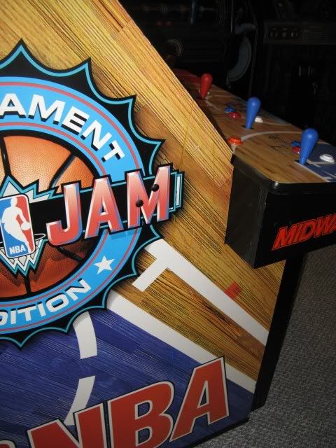

The final thing to decide on was what to do about the side art. If any of you have seen my other projects, I always strip off everything and replace the artwork or repaint it or whatever. Well, there's nothing out there for this cab. My only option would be to buy a scanner and scan the entire side and have it reproduced. I may eventually do that. However, I don't have time to mess with it now, and my kids both have their birthdays coming up, so I needed to think of something to make this presentable. I used a combination of Sharpies and was able to take care of a lot of the gouges and scratches. I found that you could actually blend different colors to get a better match:

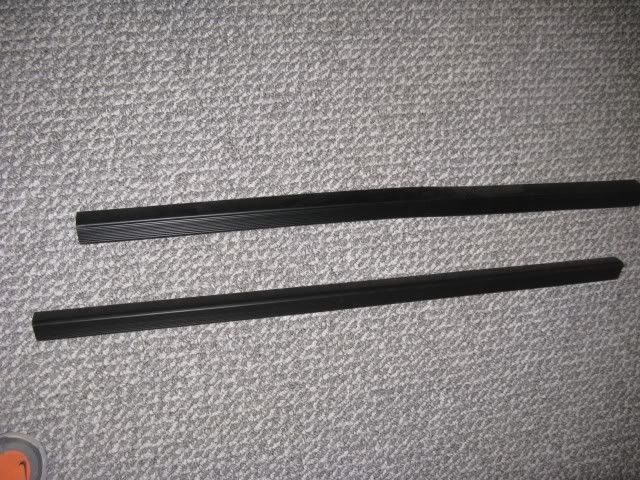

Some of the larger gouges I just left, because the particleboard underneath actually somewhat matches the floor board pattern of the sides. However, I still had the chipped junk on the bottom. That's where these cool guys came in handy:
They're some sort of black vinyl edging I found in the carpeting department of Home Depot…and they were the exact length of the cab! I had to thin them so they'd fit underneath, but after tacking them to the bottom, they covered up the worst parts pretty well.

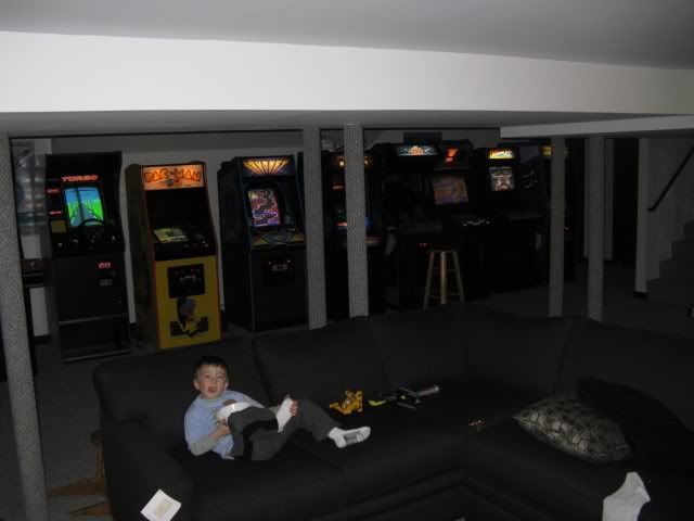

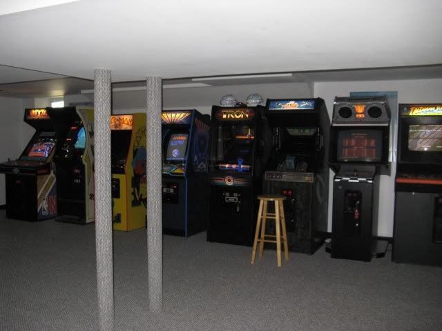

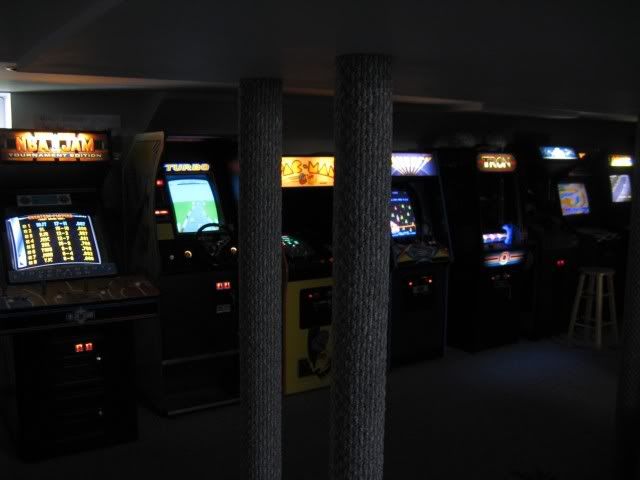

And into the lineup!

No, I didn't do all of it in 2 days ;) it actually took me about 2 weeks. I basically had it all done before Wednesday, when I started running around getting it scanned. I stripped the control panel when I got back later that day, and finally get it all installed Saturday morning. I'm not re-installing the control panel plexi, because I hate the look of it. I covered the pre-cut CPO holes with some pop-rivets, which are flatter than the original security screws. I also replaced the locks and used Teflon leg levelers.

We'll see if the scan ever comes to fruition. I'm to the point where I really can't fit any more than one more game in the basement, so that means no other "projects". That's when I'll probably get bored enough that I'll get around to scanning it. As for my next project, my 6 in 1 JAMMA switcher came yesterday with extra 3rd and 4th player wiring harnesses and 3-way wire splitters. I also bought some diodes, so I need to figure out how to put it altogether and start adding boards.
ah, you can easily fit atleast 6 games around that couch and those poles. you could make a life sized labyrinth ;-)
