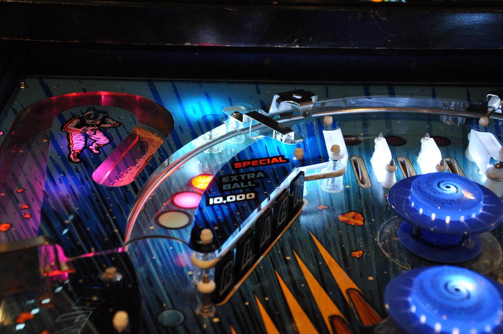

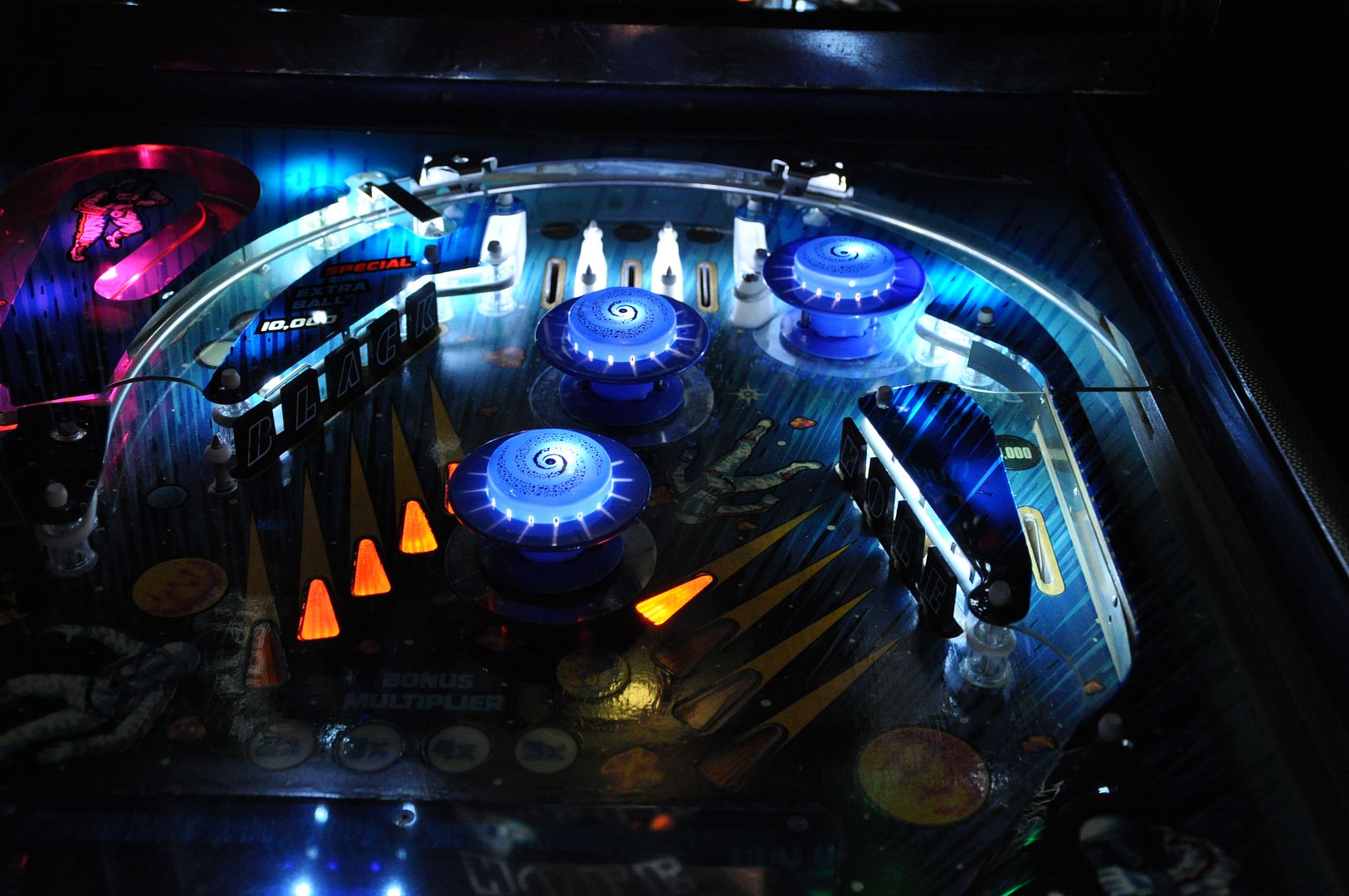

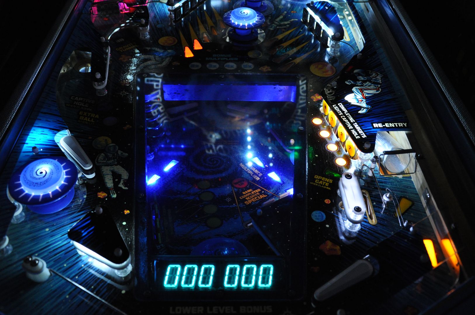

But, first you need to find the "L" relay. That should be located under the lower playfield. There should be an orange-slate-slate wire. Desolder and cap/tape it off and secure it out of the way. That's the 24v coil power. Now find the 6v DC cpu controlled light power which should be a black-slate-slate wire. Do NOT use the 6v AC general lighting power. Replace all 9 lights w/ new #44 or LED equivelants. Here's a pic of my Black Hole lower playfield. Haunted House should be very similar.
I was referring to the 313 LEDs that Cointaker has. I installed them on my old Black Hole and they simply kicked ass. VERY bright with a really cool white light that fit the game perfectly.
Sure, that will work and a very good suggestion. But, that would be a matter of preference. Those #313 LEDs only come in cool white and you get into the whole debate about cool white vs. warm white and LEDs vs. incandecents. I personally do not like cool white on any of the games unless the game is entirely shades of blue and/or black. Cool white LEDs on my red Road Kings look hideous but on Black Hole they look great. IMHO, I don't think cool white would look good in a green game. They would probably make the green very pale. That's something ixtlann will have to figure out for himself.
But, by doing the 6v mod, it's easy enough to do and opens up many options. LED or incandecent? Cool white or warm white or even colored? (which they now have UV/black light bulbs) Super bright or Ultra bright? Plus LEDs do break from time to time and where I have 100's of spare 6v bulbs, both LED and incandecent, I don't have to worry about finding/ordering a replacement. That just brings you back where we started and wishing the mod was done in the first place.
