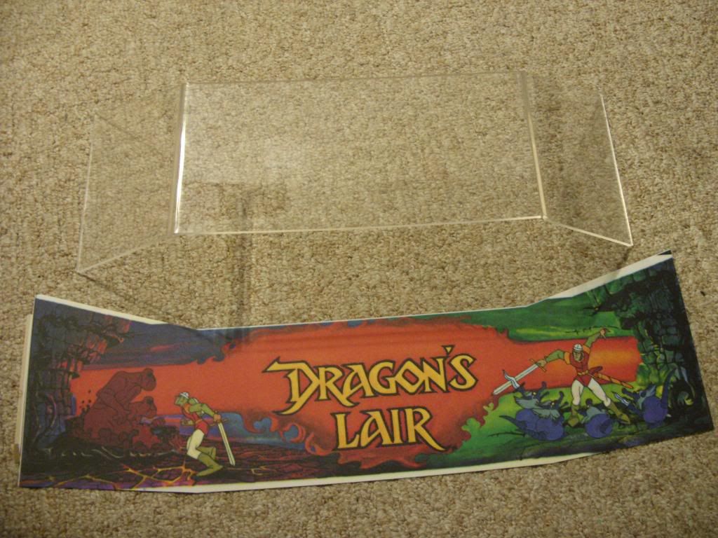

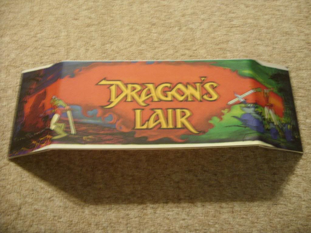

Got my new Dragons lair Marquee installed.. Its sooooo nice!! The bright colors compaired to the old faded colors is Awesome..
Wondering how many people have done these.. The removal prep took over 3 hours.. Even Goo Gone didnt want to take off the old residue..
Then trying to line up a overlay with these angles was not easy.. Anyway Got it install perfect.. I have a few tips on installation if anyone is thinking about doing one of these, shoot me a PM..

I like your approach.. It look like yours came out as nice as mine.. What i did is applied the top flat part first.. You could see where the overlay made its angle... I removed the backing in the middle to just a hair past the angle on both sides.. Once I got the middle section aligned and applied, I removed the backing on each of the short sides one at a time, and worked the overlay outward away from the center.. Worked very well:) no bubbles and is in the perfect position...
