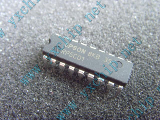

I just noticed that the U6 chip on the SPO security board has a slot in one of its two circular areas, which makes it resemble the head of a screw, and Ricoh RP5C01 chips have that same thing:
And so does the Epson version:
U4 is likely a RP5H01 PROM... I'd guess the rest are standard TTL chips. Obviously the boards are hard to come by (I've never even seen one in person), but it'd probably be really easy to identify them with a logic analyzer.
That makes sense, but if that's the case, then it sucks, because to replace one you'd have to be able to program it. This guy made a reader and programmer for it - http://www.syf.nl/ - but it's restricted for use with certain PC-10 and SuperSystem chips.
