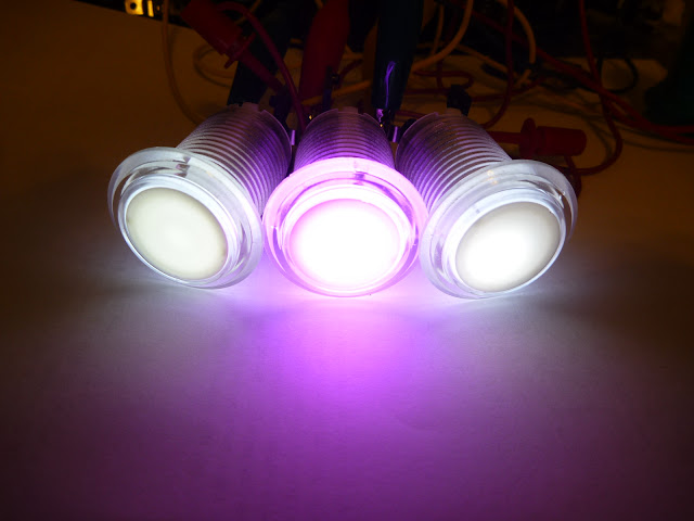

I can get bayonets that would be powerful enough, using 1.5 watt red smd's they look great, you can see some of the stuff I've been playing with here.
http://picasaweb.google.com/armi0024/ArcadeButtonsAndLEDS#
The plates of led's are ok, but if you are trying to shoot through a small hole (ie. a button) that's like going to target practice with a shotgun, yeah you hit the bullseye, but you also hit everything else around it. The single high powered SMD's are very directed and very bright.

1 and 1.5 watts are really pricey but also will just fit in the bayonets, my personal fav was the white button I was lighting up with pink LEDs, just fun, not a traditional leaf, but fun:
